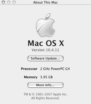

Or.. The CPU PVR (version) has been changed via Open Firmware on a Dual G5 2.0Ghz machine with 4GB of RAM and one processor removed?
Reactions: amagichnich
Really, it's qemu-system-ppc, seems you can boot with up to 4048 Megabytes under Tiger, but I haven't pushed the system past 2GB of ram use to know if it will crash.
Beyond 4048MB the kernel panics at boot time, nor can you load OS 9 with that much ram, and even if you could OS 9 can only use 1.5GB, tho it's not even stable in qemu with that amount of ram, seem qemu and OS 9 are ok with 1024MB.
