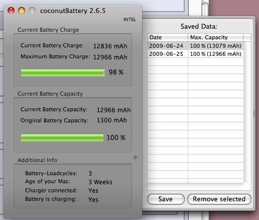

Why does my coconutBattery say original capacity 1300 mAh?

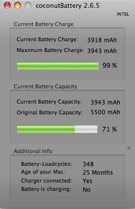

Screenshot or gtfo! :p
Screenshot
It's probably just a bug with coconutBattery since it hasn't been updated with the new batteries I guess. I can say with confidence it's obviously 13000 which is your original capacity.
So does mine (17" MBP).

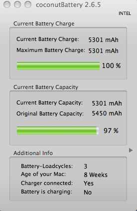

current: 5352
Original: 5450
health: 98%
loadcycles: 1
age: 3 weeks
already calibrated it once and it actually decreased my health....

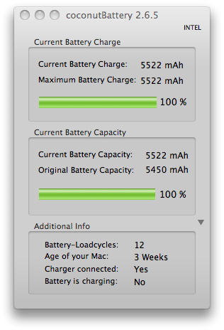

How did some of you batteries get upto like 5750 out of 5450???
^ Leave it plugged it for an hour or two after it fully charged, if you did this and nothing that means your battery is below standard, not all batteries are made the same, some hold a bit more charge then others and the same the other way around.
Thanks for the tip! I left my charger on during the day after I drained it and when i got home that's when I saw it at to my surprise at 5301. I drained half of it and started plugging my charger in again and it's showing it shot up to 5358 mAH so I'm sure it'll increase slowly?
