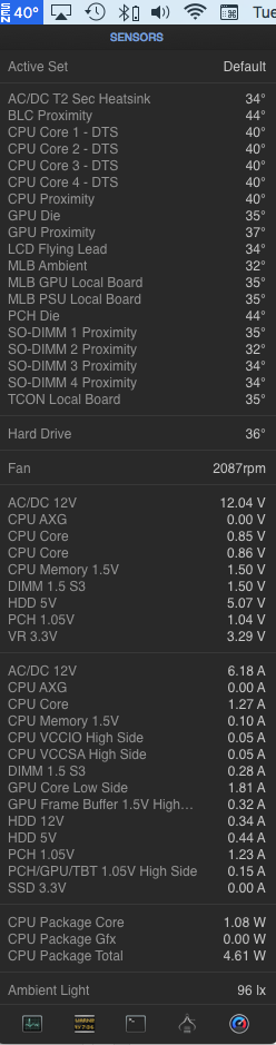

My PCH die seems to be sitting at 44°C no matter what, and it’s causing my iMac’s fan to constantly run at >2k RPM.

I might have to do an SMC reset, Macs Fan Control in Boot Camp might be causing interference with the Mac side of things.

At the top, you "active set" is set to Default, mine is on Off, could you try that? 🙂
Tried it, did an SMC reset, still running high at >2k.

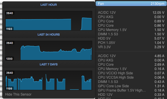

Interestingly over the past 7 days the fan was at idle for one short period:
I looked across all temperatures during the period that the fan was at idle, and none of them were any higher or lower. Something weird is going on.
