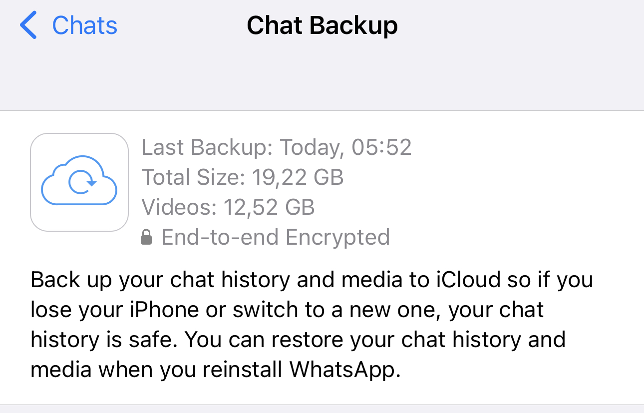

Backup was successfully done!

You don’t need to wait that much on each try.
After starting a manual backup, you should wait a few seconds….if it’s still on preparing, just force close the app and try again after toggling Include Videos
You mean toggle off the toglle on again, force close the app and then try again?
Porthole0676 had luck with a simpler version of the procedure:
Try a manual backup, if a few seconds pass and it’s still on “preparing” > force close the app and try again
Repeat as necessary. It should work after a few attempts.
Do it quickly (not sure if this is important but’s the way I do), don’t wait between attempts.
