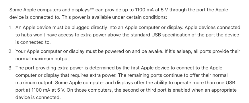

Ahh it says it but you missed it....
500 mA is standard USB charging power. If a device that requires more power to fully charge (IPAD) then you'll only get it when it's awake.
500 mA will charge an iPad but generally not all the way up and it will do it very slow. This is why the wall wart that comes with the iPad is so much larger than the one that comes with the iPhone.
Again like I said, it will charge, just not well.

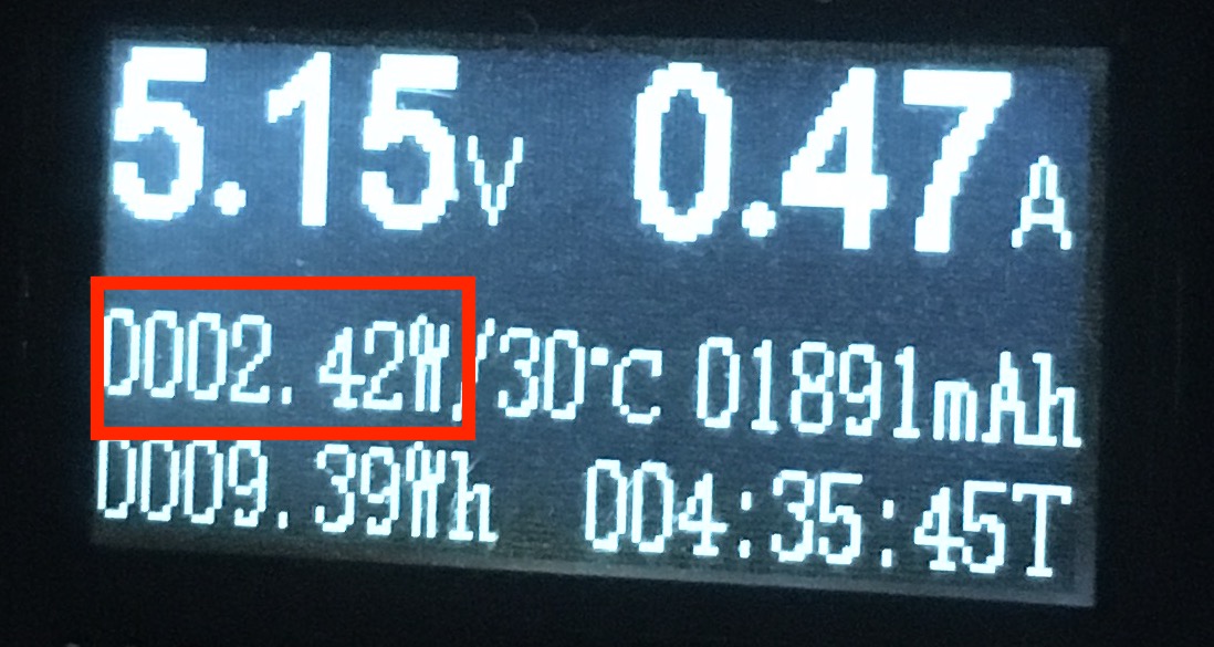

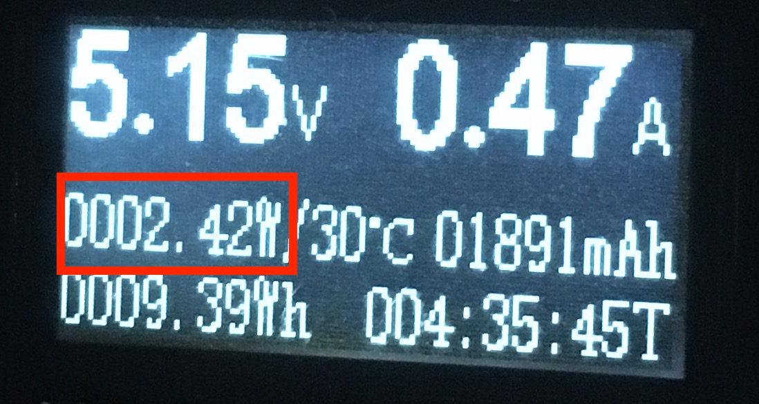

500mA USB Hub,

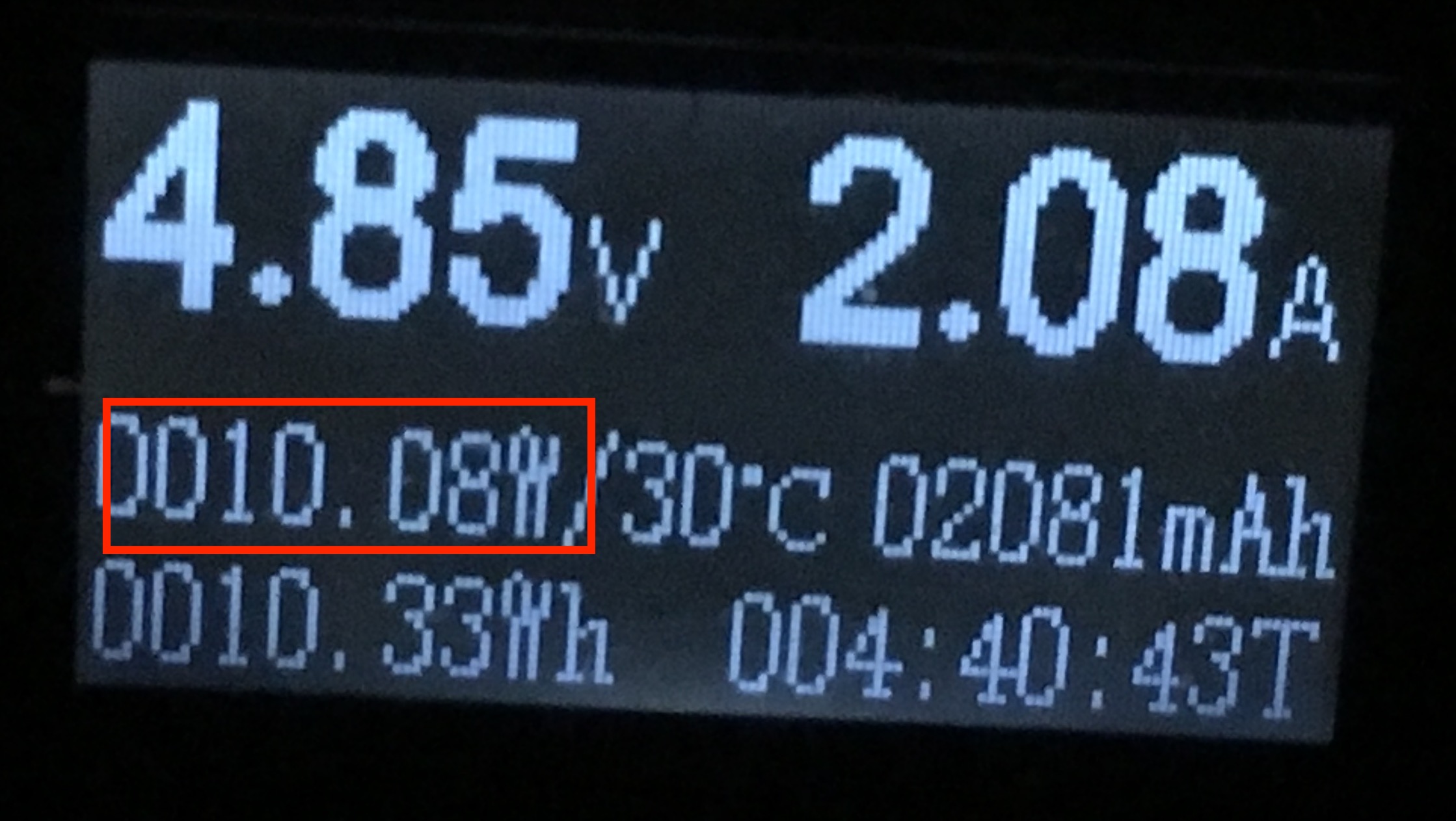

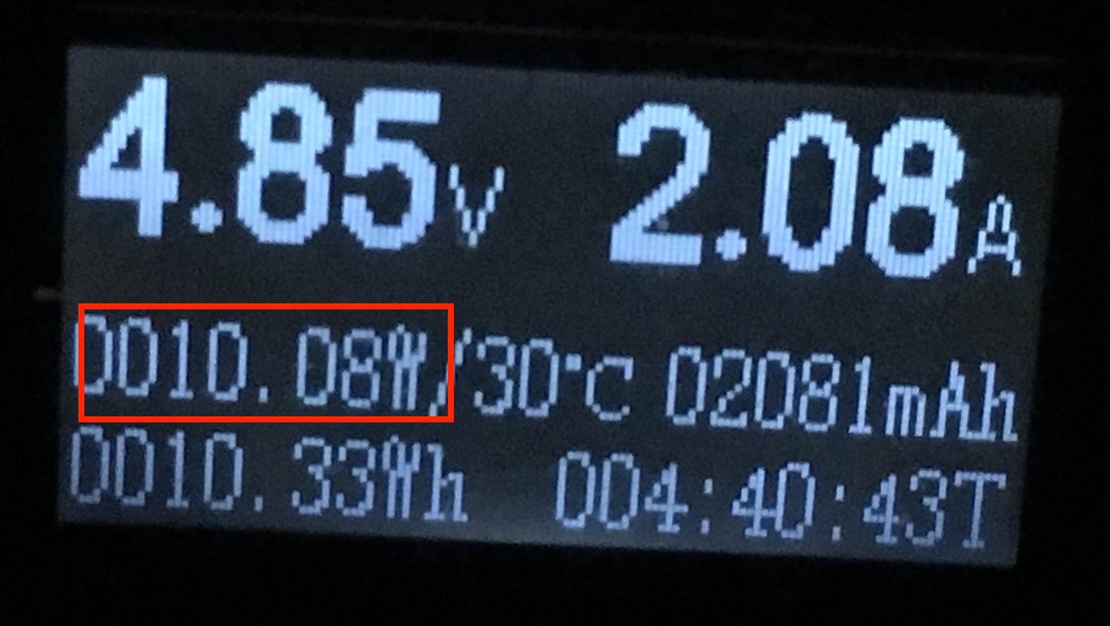

2000mA charging station,
I couldn't directly test it into the iMac because it didn't like the USB tester for some reason. However volts x amps = watts. 5v x .5A (500mA) = 2.5w, 5v x 1.1A (1100mA) = 5.5A. My USB charging station is maxed so voltage is dropping a bit.
