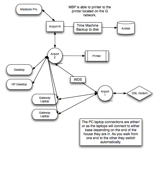

Here's a flowchart of how I did my network with all computers and accessories.
Hope it helps!
