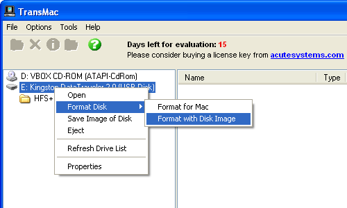

I'm using 'Transmac' on the Windows 7 platform to format the USB drive with an image of Snow Leopard.
Again on boot up and pressing 'Alt' the circle appears prohibiting install.
Is there any way to create a bootable USB with Mac OS X using 'Transmac' without getting the circle appearing?
I would use 'Disk Utility / CCC' but I don't have the Mac OS X installed what so ever.
Thanks for reading.
