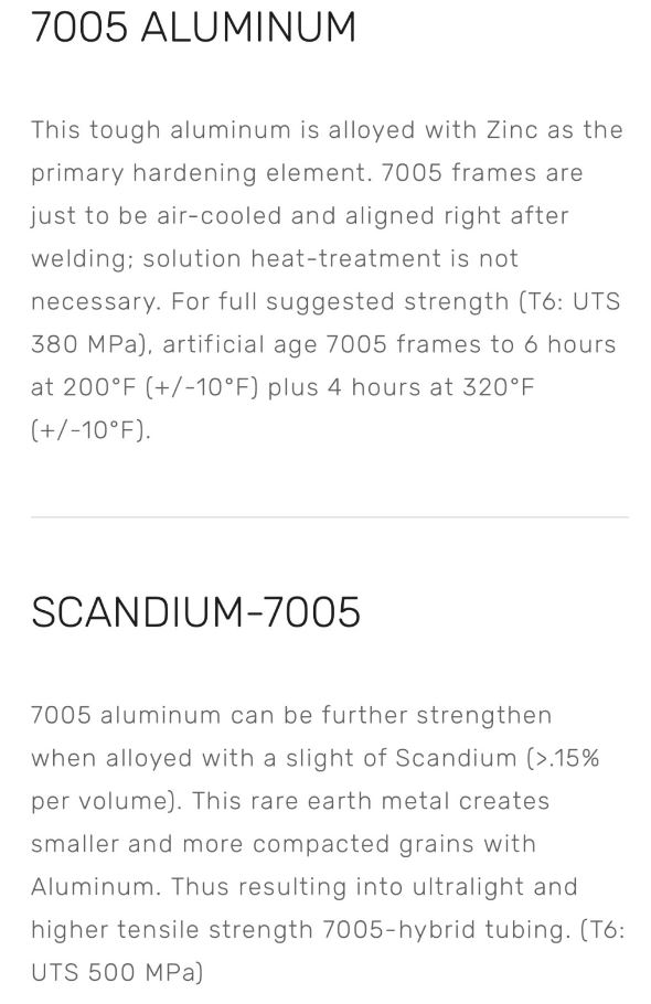

Apple is most likely using 7005 Aluminum, it runs about $1.76 per pound.

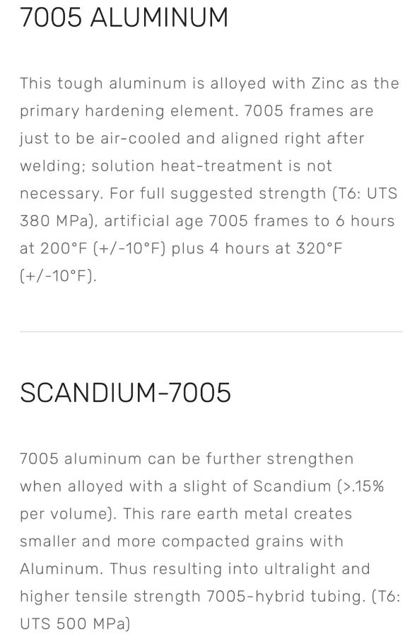

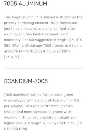

No I mean specifically 7005 aluminum.
7005 is often used for bicycle frames.

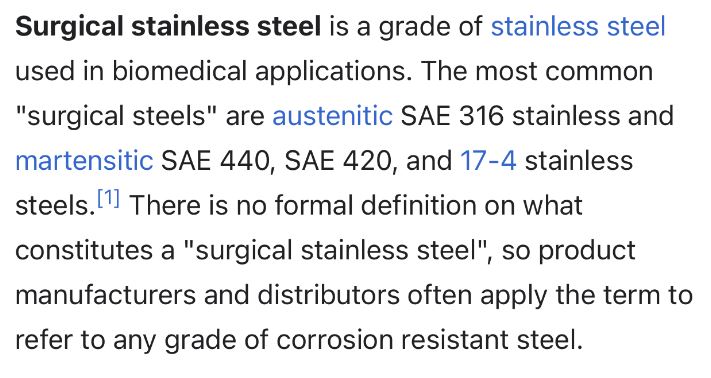

Are you really basing your arguments on marketing terms like “aerospace grade” and “surgical grade”?
Speaking of which, 316L is “jewelry quality”?
Is that kind of like... "jewelry grade"? 😅
Is “jewelry quality” some official specification you can refer me to?

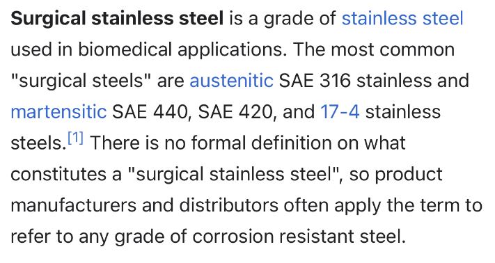

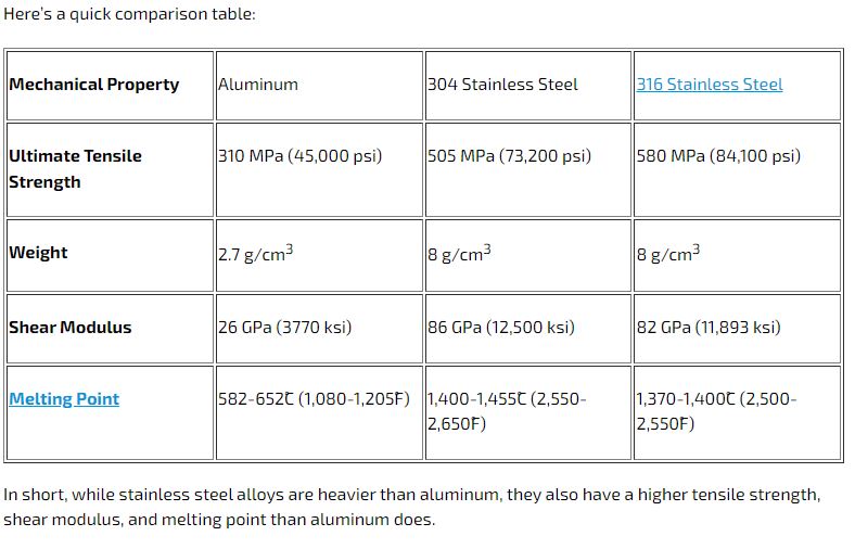

No, 316 is more corrosion resistant than 304 largely because it has roughly twice the nickel & chromium content with the addition of Moly.
316 also will hold an edge better than 304 which makes it a superior choice for surgical tools.
316L specifically is the is most common surgical steel, L meaning low-carbon.
316L is relatively biocompatible and that’s why it’s use most often for implants, piercings and…you guessed it: the vast majority of surgical equipment.
We know Apple used “surgical grade stainless steel” to refer to 316L based on older Apple Watch marketing.
My assumption is that continued for iPhone given the higher corrosion resistance 316 and the lack of surface oxidation I experienced on my silver iPhone X in spite of repeated salt water exposure.

So 7075 Aluminum has 7 times the strength to weight ratio, is similar to Titanium, has better heat conductivity, and is lighter.
SS is denser and stronger. Heavier, has little to zero heat conductivity and it's weight to strength is very poor and is cheaper. You are saying it's the right material for the job? 😂 Yeah. OK.

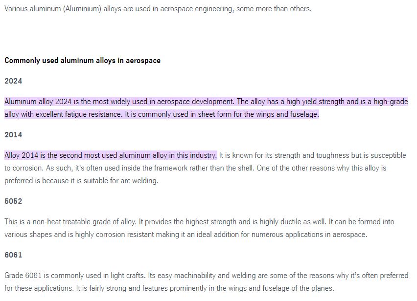

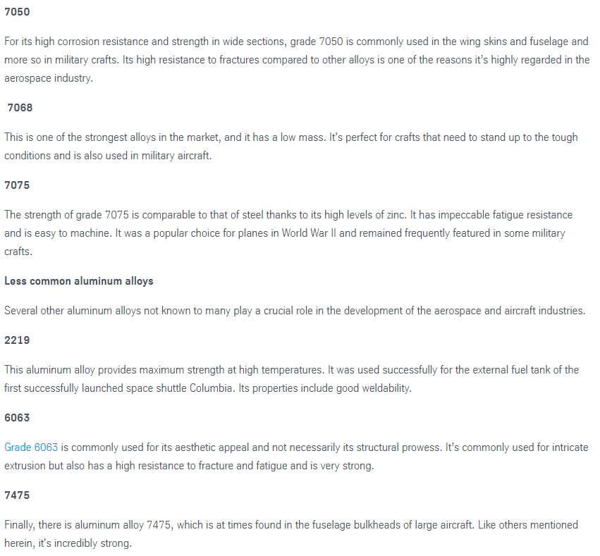

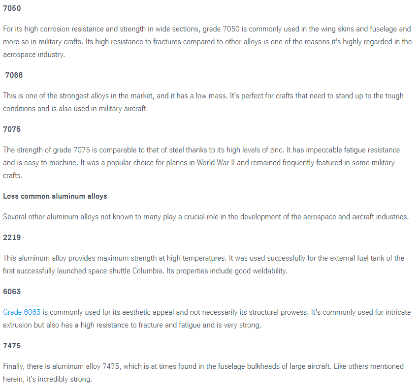

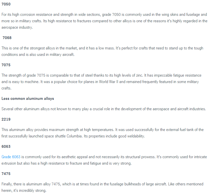

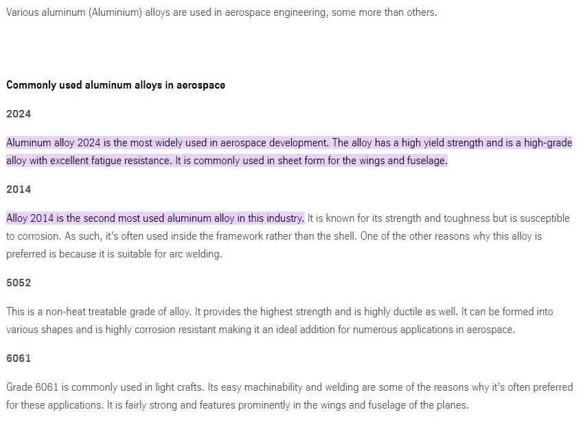

"Aerospace grade" means nothing, it is not a specification.
7000 series aluminum as a whole is generally accepted to be "aerospace grade".
But you honestly believe the aerospace industry uses 7075 and 7050 specifically?
You'd be dead wrong... again:
Bare, uncoated SILVER stainless steel is more prone to micro-scratching than anodized aluminum.
PVD coated stainless (every version that ISN'T Silver) is not more prone to micro-scratching, I too have owned both and the difference is plainly seen in the videos I linked.

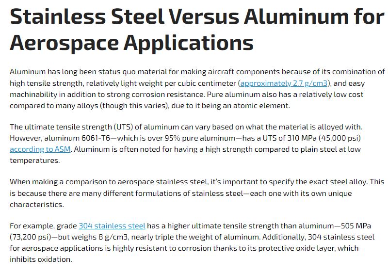

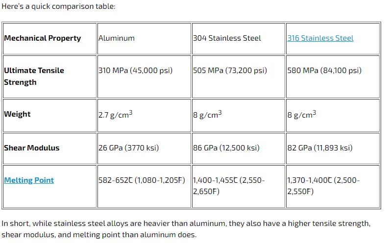

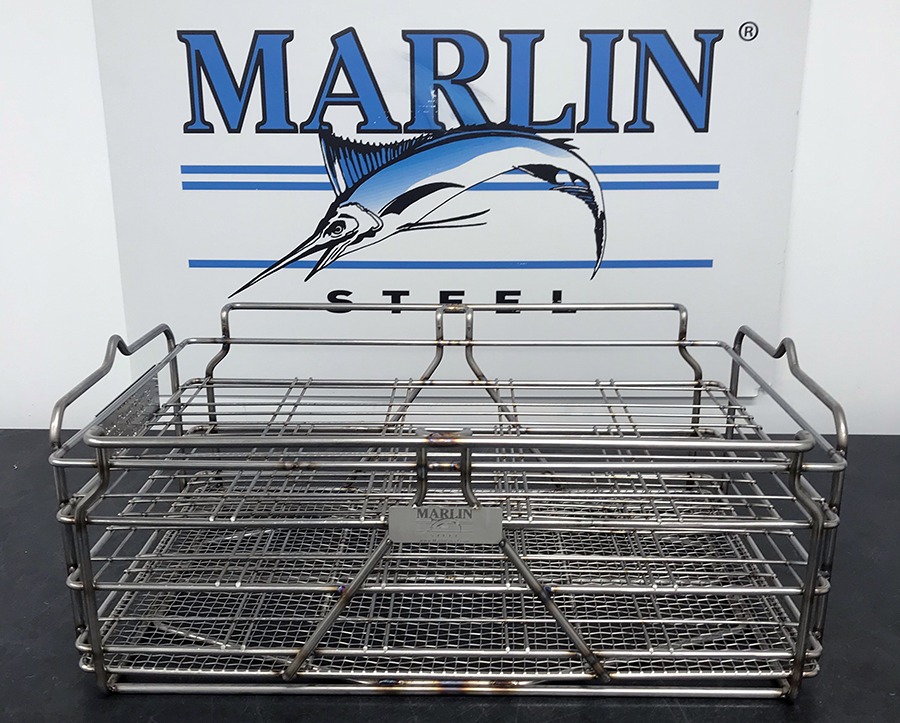

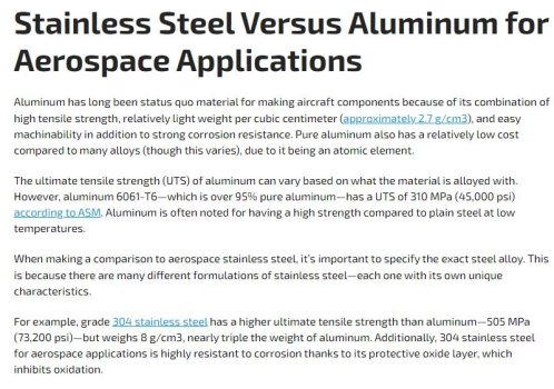

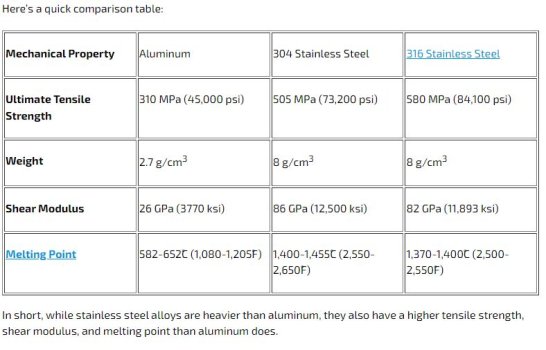

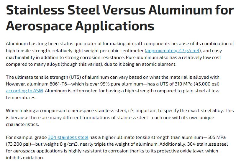

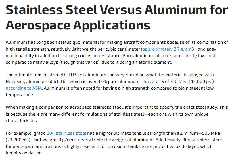

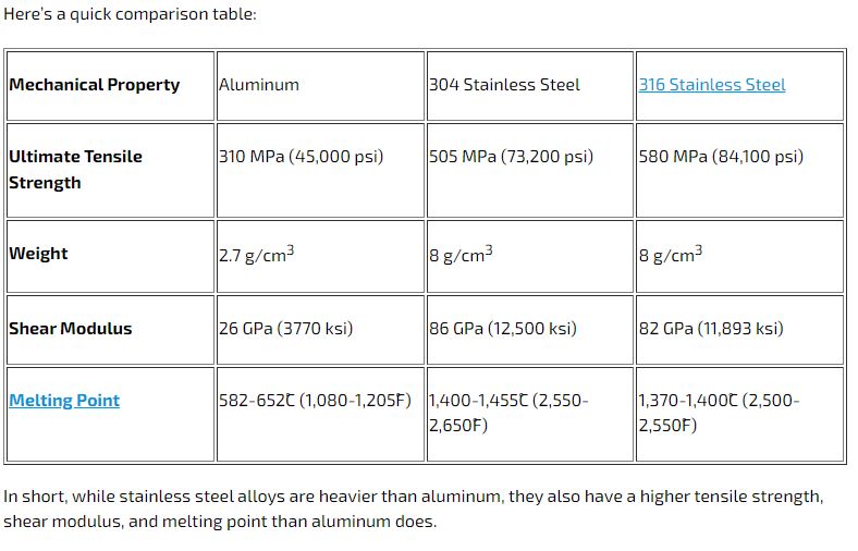

You do realize steel and stainless steel has a significant role in aerospace as well, right? 😄
How about that "aerospace grade" stainless steel?
It's laughable you you would accuse me of being mislead by marketing when the full extent of your materials knowledge seems to be based entirely around marketing terms like "jewelry quality", "aerospace grade" and "surgical grade".
View attachment 2075278View attachment 2075279
The point is that the band makes up ~10% of the iPhone's surface area, AL's advantage in heat conduction makes little difference in the overall temperature management of the device.
Yes you are confused by marketing. Simply by stating that SS is the right material for the job. Again you fail to explain why exactly with nothing to back up your claims. No answer yet?
And 7075 and 7050 are the most widely used in actual spacecraft.
From your own article.
They compare 6061 to 304. Not 7075.
"7075 is a combination of aluminum and zinc, and is the most commonly used alloy in aerospace applications due to its excellent mechanical properties, ductility, strength, and resistance to fatigue."
Am I still wrong? Or are you?
The article you provided included planes etc. Yes the specifications do mean something. Heat treated T6 for example. You don't even grasp basic concepts. No sense reasoning with you as you will manufacturer false facts to back up your claims.
I know the differences between the two. Seems you do not. As shown above.

5. If you knew anything about the topic you wouldn't have claimed 316L isn't "surgical grade" or that 7075 is the only aluminum alloy used is aerospace applications. Both of which you did.
I'm not going to continue a tit for tat discussion with a troll who has firmly planted himself in willful ignorance.
Have a nice day

5. No I did not. Again putting words in my mouth I never said. I never said 316L isn't surgical grade. I actually said it's the mostly used metal for surgical equipment. The complete opposite of what you are claiming. Look above. You are lying again to fit your argument.
