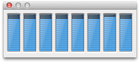

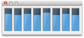

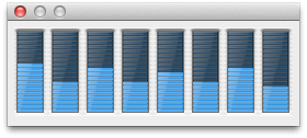

I'm using Premiere Pro CS6, and tested it with each render mode (CUDA using that hack). Here are screenshots of the CPU during each mode:
Software Only - It doesn't move that much
OpenCL - It fluctuates considerably
CUDA - It fluctuates considerably

You want to max out your CPU. Yes it means there is a bottle neck but it means that your CPU is the bottleneck.
I have a ton of BMCC footage to convert and if I hadn't configured AE to use all my cores and ram I would be sitting here for an awful lot longer!
If your CPU is pegged then your CPU is the limiting factor in speeding up the render. In theory, using software rendering if you could speed up your CPU then you will proportionally reduce the render time. That is, doubling your CPU speed will cut your render time in half.
In reality, doubling CPU speed is typically not possible. Additionally, even if it was possible to dramatically increase your CPU speed you would not be able to realize the render time reduction because increasing the CPU speed would cause other parts of the system to be the bottleneck (RAM speed, disk speed, interconnect speeds are likely to be hit.)
With OpenCL, and CUDA you are utilizing processing power in your GPU that is not reflected in the CPU meter. In these cases, since the GPU is doing the heavy processing of the render the CPU is primarily responsible for shifting data to and from the GPU. In these cases a GPU monitor is likely to show that the GPU is pegged. Since you don't have a lot of video RAM your GPU using CUDA might not be reaching the potential processing throughput that the GPU core provides.
However, all of this is largely irrelevant. For any particular file, rendering the file using software-only rendering almost certainly takes the longest time as measured by a wall-clock. OpenCL and CUDA are both using the GPU hardware to perform the rendering so will take different lengths of time but the difference between them might not be significant. It is certain that the hardware rendering approaches will be significantly faster than the software rendering.
Assuming that software and hardware approaches produce the same output quality, pick the approach that pushes through the workload faster. There may be differences in output quality or characteristics because of the different code paths involved. But in general, each of the three options are intended to produce equivalent output.
