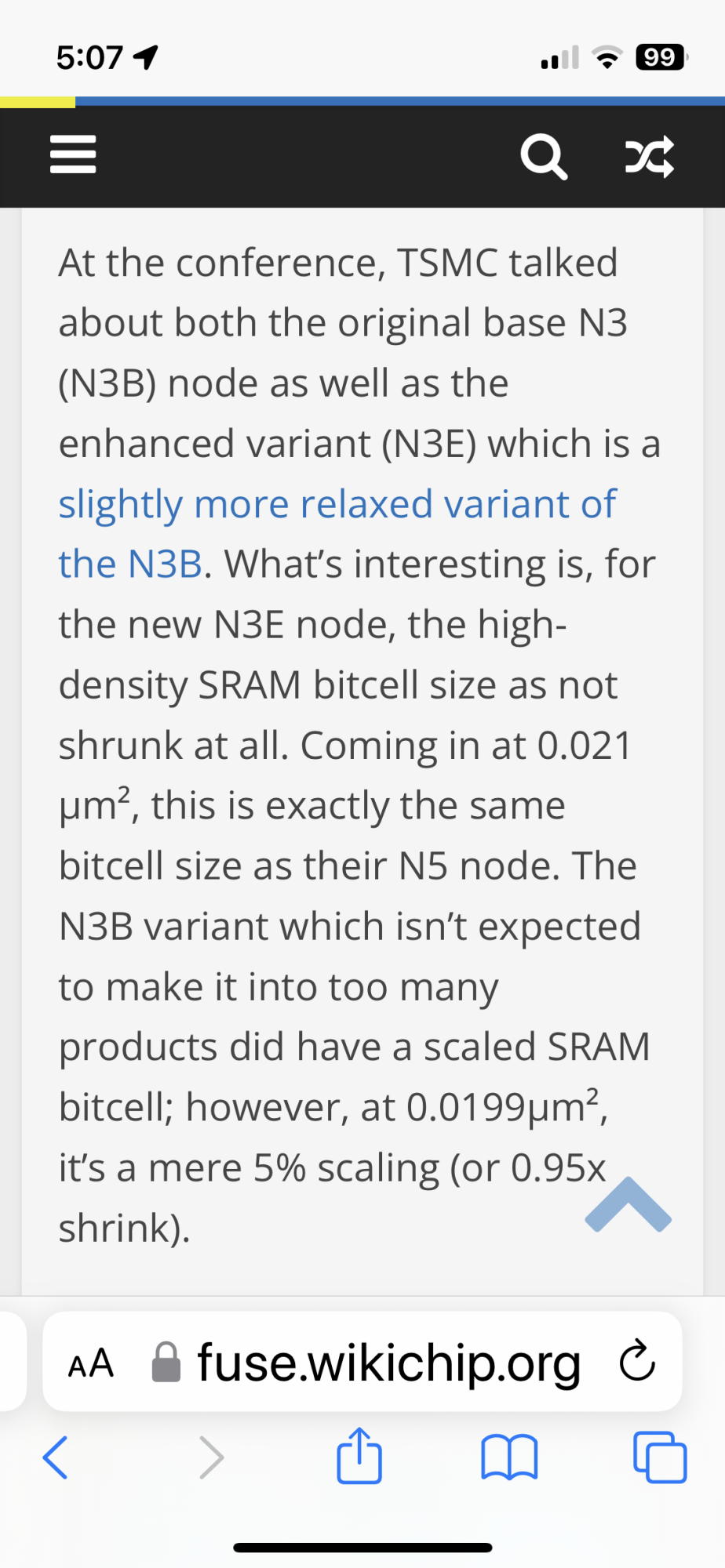

So which features would you cut out to justify a new "non-Pro" name? Normally the exact same chip on a different process keeps its name.
One of the biggest difference is 3nm offers almost no SRAM density improvement. I would expect smaller cache. GPU cuts for sure. Maybe also lower clock targets.
