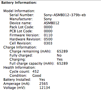

What is up with this battery?????
Hey everyone, I charged my battery last night, took it off the charger before I went to seep. I opened it up this morning to see 100% battery, which was a surprise usually it drops to like 60% over night. Anyway, MY MBP just turned off and made the "bliinky" noise. Tried to turn it back on but it wouldn't until I plugged it in. Now It is on but my battery specs are abnormal. Compare my previously posted battery specs with todays and it looks like I have a new battery.
WEIRD, Is my battery finally done for???
65289 mAh from 2039 in 8 cycles, Seriously??? 😕

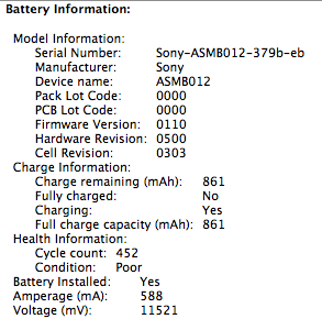

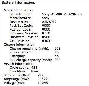

I restarted again and here are the results
