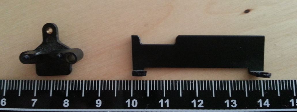

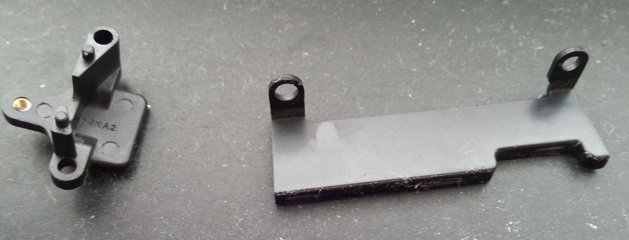

Yesterday we disammbled our macbook to replace the keyboard because a few keys weren't working. After putting everything back together the macbook seems to be working perfect again, but....there a two pieces left over and we have no idea where they had to go...Searching on google hasn't helped me find these exact pieces, could someone identify these pieces, and maybe tell me to witch part they belong to? I've left the laptop off after testing just in case these are essential parts or something...
In the picture you see the parts, the smallest part has the number NSX A2 on it, and the other part says ZY1.

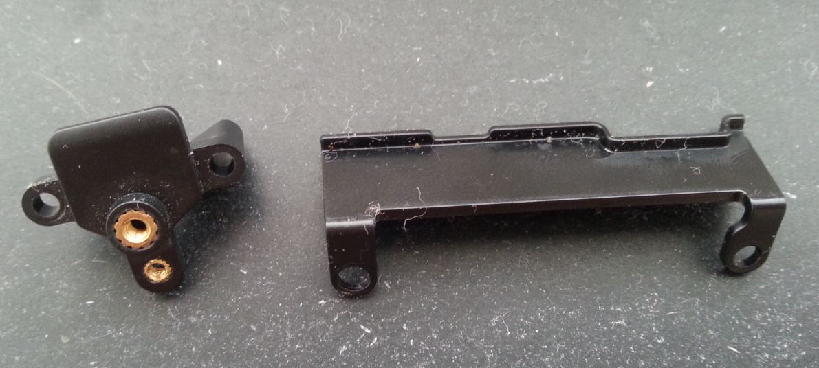

Ok thank you very much so far for your effort, yes i'm sure these were left over putting everything back together...I've added another picture to show how big the pieces are.

I'm a certified apple tech, I can tell you the pieces on the left of your picture are part of the hinge assembly on the body side of the laptop. You will find that the little nubs have a hole they fit into. They also hold down the lvds cable so that they dont get pinched during reasembly. As for the other pieces, I really dont know, and I'm away from my repair manuals as I'm on a mobile at the moment.

No problem, I'm also one and have GSX handy. That second one looks like it might be the front HDD bracket.
Looks like you have an 08 aluminum MacBook. Piece on the right looks like the trackpad flex cable bumper. Piece on the left looks like the camera cable guide

Nope, not an '08 based on the post I quoted...
Here ya go
The left pieces is the webcam cable guide that attaches on the left side with the bottom cover open. The big nut is for the retaining screw that locks down the speaker and the little nut is for a small clip that extends out to the base of the frame.
The other pieces goes between the keyboard ribbon cable and frame. So you take the screws out holding the motherboard. Then insert this in-between and then screw it down with the motherboard screws.
