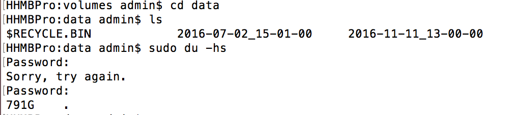

Thanks! It didn't show any details though. Just "791G".

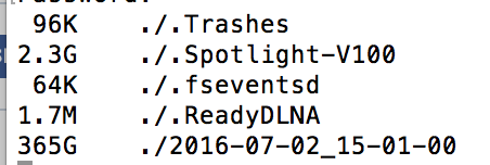

This is strange...
365GB reported through du but Finder reports 83GB.
It accounts for the discrepancy but how can I resolve the issue?
