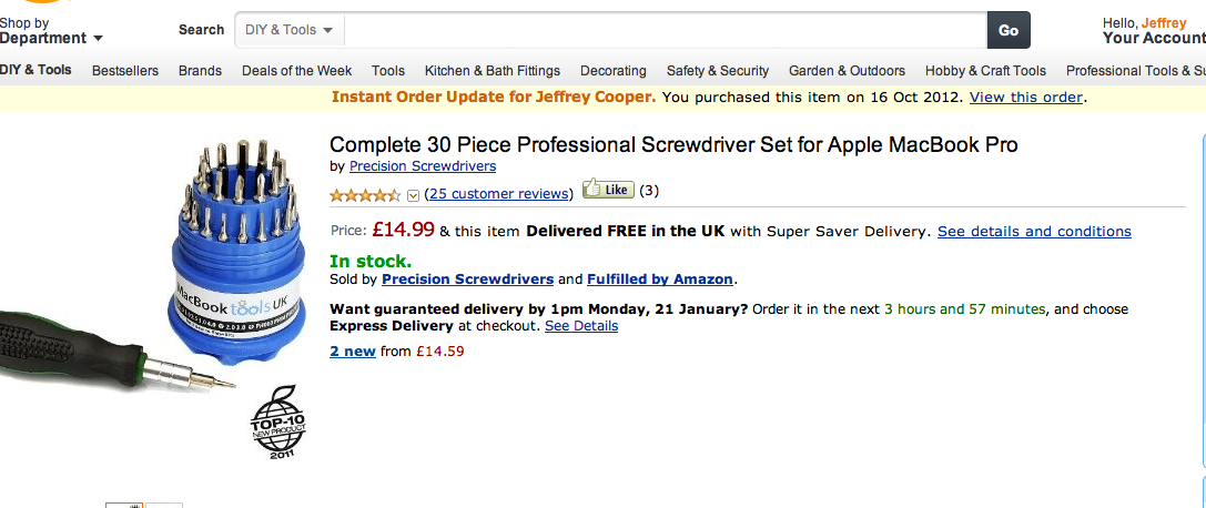

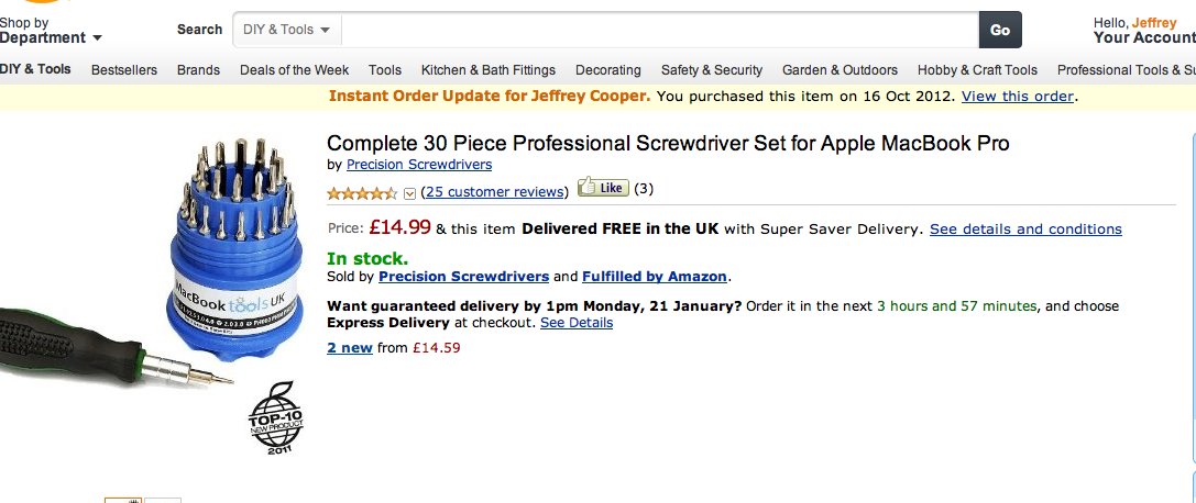

I bought this one from amazon....Covers everything you need...I got it to upgrade the RAM on my 17" MBP, but it's got the lot.
