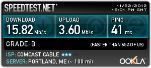

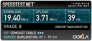

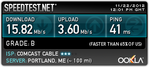

Here two tests using two different servers this AM. The latency is up a bit - around 40.
What is latency anyway?
Basically a measure of how long it takes from a signal to reach the other end. It's measured by a 'ping' - basically sending a tiny packet of data and testing how long it takes before the other end reports it as having arrived.
It matters more for some services than other, but it's important for streaming services. A lower number is better, and at 35-40 yours is a bit high.

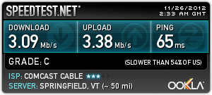

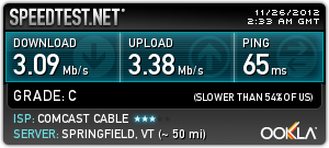

EDIT: Not so fast - yesterday and today the evening speed results are awful - check this out:
http://speedtest.net/result/2331882461.png
UPDATE - I discovered this AM that the slow speeds are evident when my machine is inadvertently connected to an older wireless access point down in the basement which I am now going to disconnect. Could well have been the source of my troubles. Using my TC as the wireless the speeds are up to snuff.
