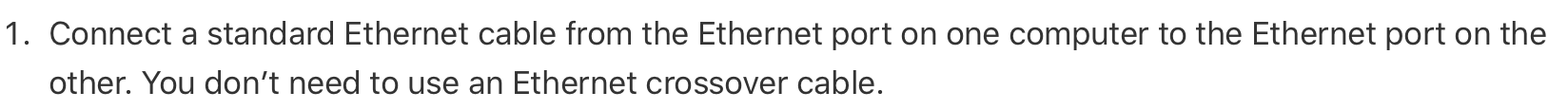

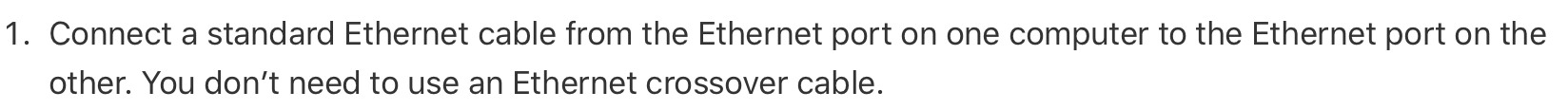

Actually you can connect two Macs directly with a regular ethernet cable, I have done it many times; screenshot from support.apple.com:
