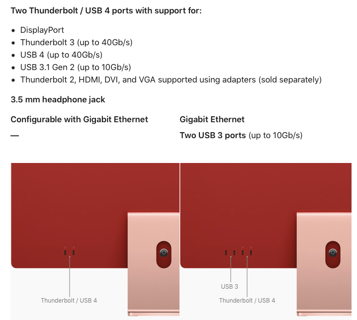

The $1,299 model can be configured with "Gigabit Ethernet." With the more expensive models, it comes standard. Maybe I am losing my mind but I cannot locate this port on the new iMac for the life of me. Does anyone know where they put it?

Per Apple's site you can get 10gb/s ethernet through the USB 3 ports
Don't believe so, the 10Gb/s is referring to the USB 3 ports speed. The Gigabit Ethernet is brought to the computer via the power brick with a standard Gigabit Ethernet connection, which it seems you have to pay extra for with the base model, there is no direct connection on the iMac. USB3 ports will not magically become 10Gb/s Ethernet ports if back at the power brick is just a standard Gigabit Ethernet port.
