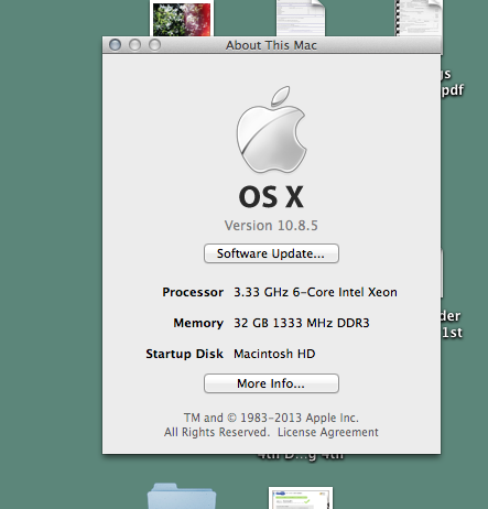

Update: success
So, I just replaced the stock 2.8 quad core with the W3680 I scored from ebay.
Remarkably straightforward job, thanks to the attention to detail inside the Mac Pro case. I followed the instructions from another thread on Macrumors.
Things to note: It was a bit scary at first working out how much force to use to start unscrewing the heat sink, one screw was quite tight. Not all of them were evenly screwed down, some required more turns than others. This applied in reverse when replacing the heatsink. I just turned each one a couple in rotation and kept going until they didn't want to turn further. If you've got a torque measuring hex key you can probably be more accurate I suppose.
The spring clip that holds down the CPU needs what seems to be a lot of force to close once the new CPU is in place. That worried me too!
Anyway, the whole thing took under an hour and would have been quicker if it wasn't my first attempt at anything like this.
Booted first time and my RAM is now running at 1333mhz.
CPU from ebay from a US based seller with good feedback was £180 including shipping. Sailed straight through customs, may have been lucky there, but preferable to the "international shipping program" some sellers use, which can add £50 up front!
An excellent upgrade for under £200, should get me a few more years out of my Mac Pro.
