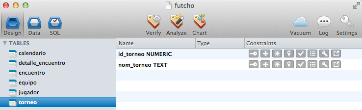

Dantastic ... I asked how it's correct to instance an object because when I have used the methods of JFBaseDatos some works bad.
The class JFBaseDatos, has a method to create tables, the database file it's created and I can review the structure all tables and it's fine ... but, when I want to insert records, I can't because I have gotten a message that a "id_torneo" column dosen't exist ... but yes..... it's exists .. I can see it in the database file.
I found the error, the syntax create table it's bad.
