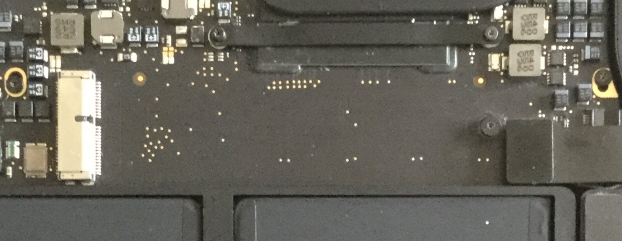

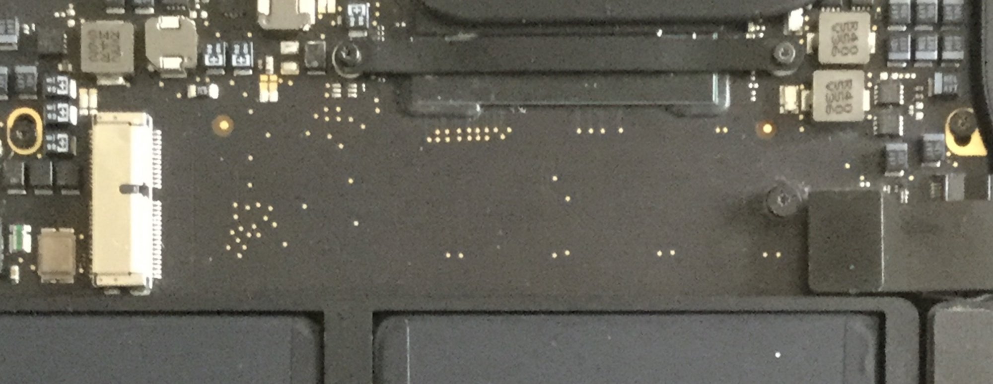

The ssuax and ssubx are compatible with the mid-2013 Air but I'm not sure if the 1 TB is physically too large. I'm going to open my Air and look.
Edit: the 1TB will be too wide unless you can cut away the frame from the battery.

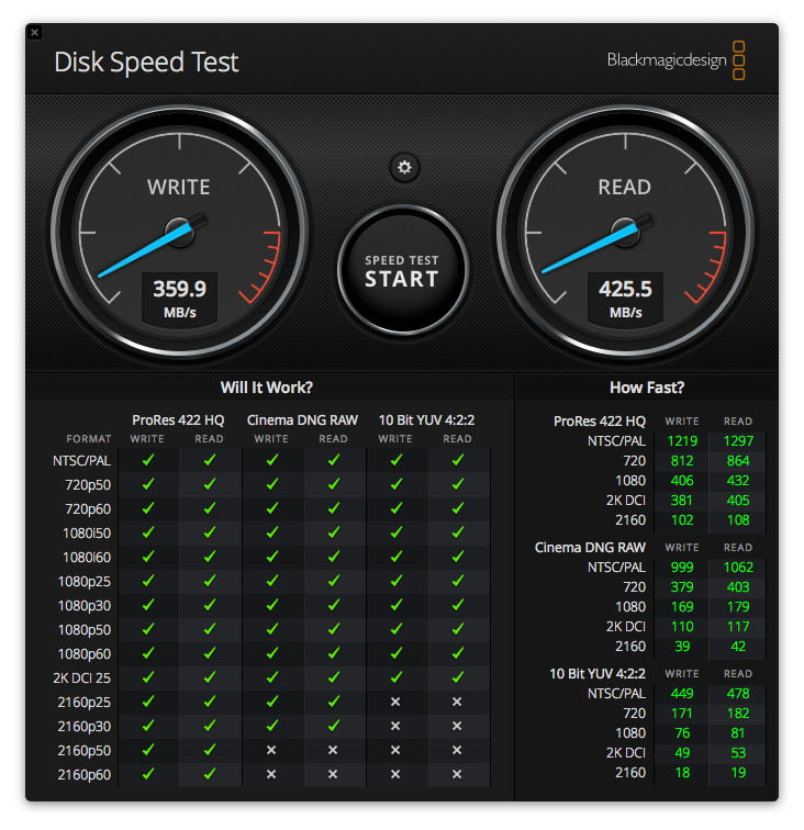

I'm loving so far my decision to "resuscitate" my 2014 MBA w/128GB by purchasing an ultra-small SanDisk Extreme 1TB SSD to replace my previously-used 4TB spinning HD as a workaround for more storage space (and instead of purchasing a $2000 2020 MBP, as it would have also required me to purchase $500+ in new 64 bit software).

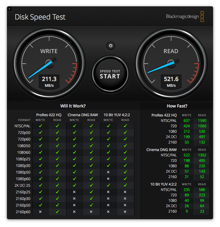

For fun I ran speed tests on my MBA and SanDisk Extreme for the first time and was rather surprised by the paltry (to me) speeds on the SSUAX. Do these seem legit, to those who understand these things better than I do? It's my understanding per the beets tech article/link shared above that the 2014 MBA has a PCIe 2.0 x4 interface, which I'd think *should* have resulted in faster speeds than those shown below?
Do these results seem legit, and - should I purchase a 512gb SSUBX, should I expect noticeably higher the speeds as reported below for the SSUAX?
Thanks for any help or clarifications on any misunderstandings on my part.
Andy
Speed test SSUAX w/2014 MBA, i7 8GB RAM:
Here's one for the SanDisk Extreme (with USB 3.0 on the MBA):
The ssuax is a two lane drive. Ssubx is 4 lanes.
Exactly, I agree.
But my question: if my MBA has a 128GB SSUAX, those #’s I got seem lower than I expected. Can anyone corroborate if my #’s seem legit?

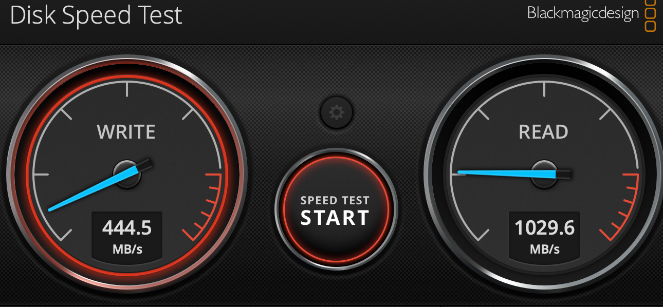

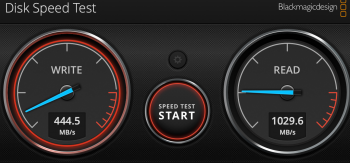

Here's a 128 GB SSUBX in a mid-2014 13" Pro.
Numbers for the Air look about right for a ssuax.
