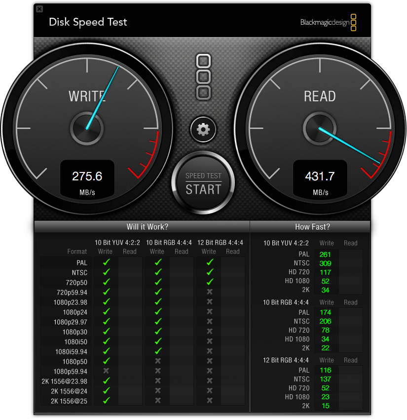

Here are the speed results I get, using a Crucial m500 mounted in a plugable.com "lay-flat" USB3/SATA dock, booting and running a late-2012 Mac Mini:

I've been booting and running my 2012 Mini from a plugable.com "lay-flat" USB3/SATA dock since January of 2013.
The dock sits in an out-of-the-way area on my desk, and is connected to the Mini using a 30-36" USB cable.
Not once in the passing 21 months have I ever dislodged the USB cable between the Mini and the dock. This includes picking up the Mini by which to make connections in the back.
Your fears on this matter are unfounded.
