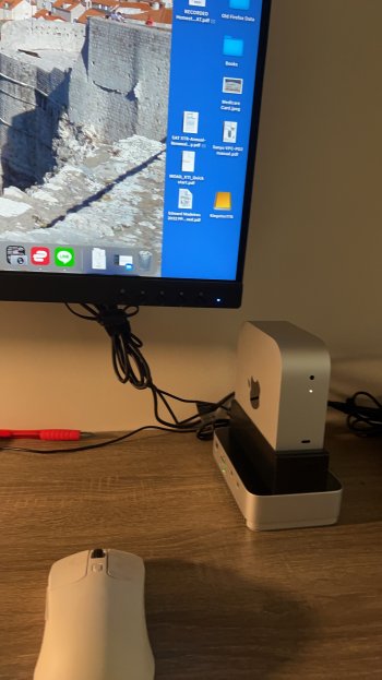

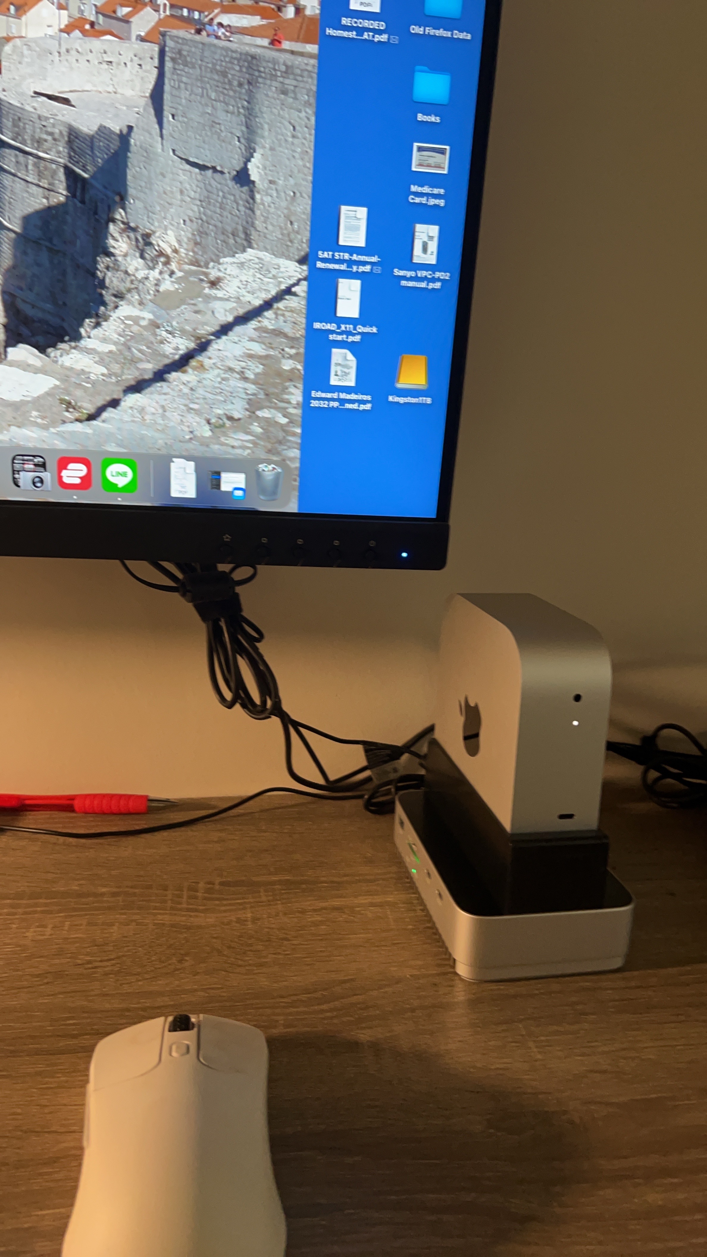

I have this slide in model by Qwiizlab UH61 M4 Been very happy with it's performance.
