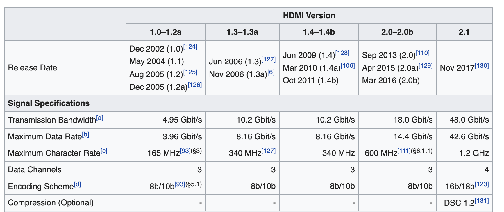

It should probably be noted that many WCG/HDR/10 bit/whatever displays (TV and/or monitors) need individual HDMI ports set to their 10 bit/UHD/deep color/ultra color/random marketing term to achieve 60hz with a resolution of 4k.
The reason this needs to be turn on with HDMI is due to a poorly defined standards and out of the box compatibility. What this setting is effectively doing is increasing the "transition minimized differential signaling" clock frequency (often referred to as TMDS clock, character rate and/or pixel clock) from a HDMI 1.3 340 mhz spec to the HDMI 2.0 600 mhz spec.
In an overly basic explanation, HDMI has a dedicated channel to sync the image and if the receiver (display) is clocked higher than the transmitter (cable box, DVD player, etc) you can get odd graphical effects. Conversely if the receiver is clocked lower than the transmitter (default setting for compatibility) you may lack the required bandwidth for 60hz.
I pulled this off of Wiki.
Newer displays may handle this better but I have an 2017 Samsung HDR10 TV that needed "UHD Colors" enabled for the HDMI port my MBP is hooked too.
