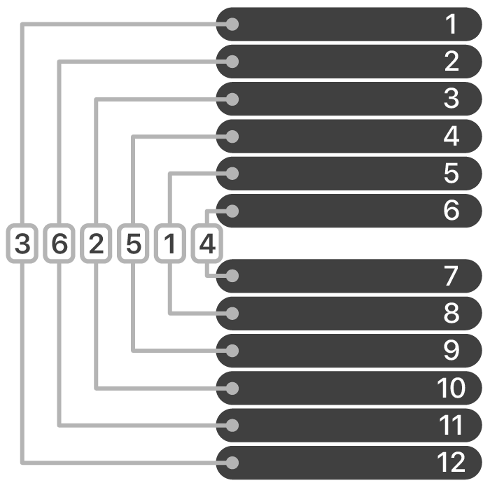

The Single Processor LGA 3647 Cascade Lake Xeon System ( Like a MP7,1 ) has two memory controllers , six memory channels and can address two memory sticks DIMMs per channel . Each channel can be determined by this chart lovingly provided by our dear friends from the Spaceship :
Reactions: majus
so memory controller one would take the first 6 sticks on 1, 2, and 3. Then, memory controller two would take the other 6 sticks on 4, 5, and 6. But slots 123 should be same capacity for optimal performance, and 456 as well?
I'm not certain . Apple probably ships the MP7,1 only with matching memory modules . That includes size . Companies like Supermicro , which manufacturer logic boards with LGA 3647 sockets , say all the memory modules must match in a System . I suspect they are worried about some otherwise similar modules having different timings , etc , that might drag System performance down to the lowest common denominator .
