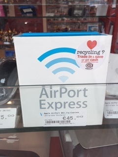

I saw this Airport Express in a shop yesterday for €45, and I although I know its not the current generation (is it the previous one???) I was wondering if it could work to solve a problem for me??
I have an Airport Extreme (generation before the current "tall" one) upstairs, and would like to strengthen my wi-fi signal downstairs primarily for my Sony TV and Amazon Fire Stick both of which struggle to get a signal.
Would the Airport Express pictured above work with my set up? Or would I be better with the latest generation Express for €109??? Or can anyone suggest anything else that might solve my problem?
That Express appears to be a wireless G model if I am reading the label correctly. At roughly $50 USD, that is hardly worth it considering we can get refurbished models right from Apple for $65 USD. See if Apple has a refurbished online store where you are located.

look for 802.11N
if it doesn't have the N, you'll have problems configuring it.
The G version isn't supported by the current airport software, and the old airport software requires some work to make it run on the current versions of OS X
i agree, this probably isn't the best deal.
you're better off with a refurb current model

look for 802.11N

Thanks for the excellent replies guys. I'll skip it so and keep an eye open for a refurb Express on the Irish refurb store.
