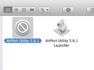

I think any upgrades you do to your network are for the better. If you need to save some money download that file from the link I provided (All Credit to Corey Mahler). Inside the DMG will be AirPort Utility 5.6.1 and a launcher for Mavericks. Drag AirPort Utility onto the launcher app. You will now be able to manage your AirPort!

Negativo Captain....

No that didn't work, I simply Option+Open and the script used the app within to open!!

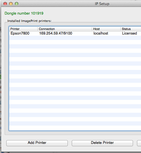

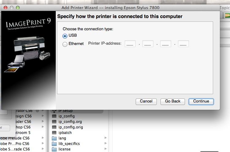

I have a question: The past 2 years I've been running this thing, and was NEVER able to print from this APExp alone. I had to create a new network at this point and 'switch' to that network when I wanted to print.
And in the process losing my internet connection until the printing was complete! (I use a RIP software called Imageprint). In the setup for I.P. I have to add the ethernet address of the port (even though it's USB)
Is there a way to access the printer without creating a new network?

A screenshot of IF I went the static route, for which I have no idea what any of that means!

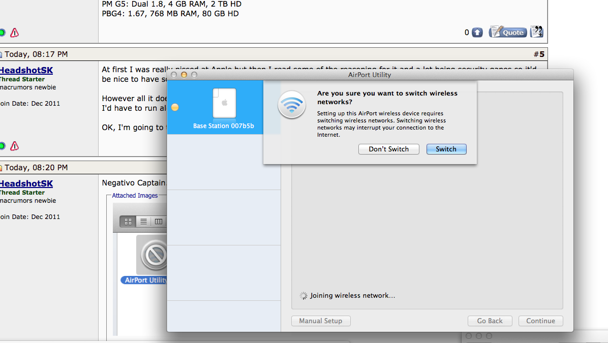

Before I check the Apple site as I'm about to, I did find the Bridge mode in APU. In order to even configure that I had to keep switching my AP toolbar icon to basestation from Rosewill.
I found the ethernet address too and IP setup accepted that.
But for the record, the Rosewill is in the attic so there's no REAL ethernet connection anywhere, the IP app is just using the port so that the USB port on the APE is fooled into talking to the printer.
Well, the GREAT news is, by using [turning off] Bridge Mode via the one legacy APU you sent me that actually works, my RIP app is feeding the printer, I made a quick test and it's back online!!
