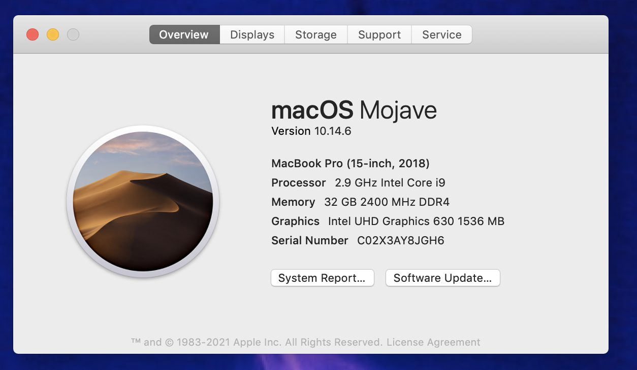

My MacBook Pro keeps having episodes where it won't charge, gets sluggish due to 4% or less despite plugged in, or worse, shuts down. It has an odd quality of charging better if I change outlets often. I have no idea why, unplugging and replugging the adapter doesn't get the same results. So I likely need a battery right? Glad to replace it if it solves this problem.
It is MB Pro 15-Inch 2018. Please see screenshot.
Also is this the right battery? I'll buy it now. Thank you.
