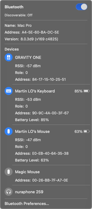

I use external antenna for BT as well. A $1 6dBi antenna from China.
Works very well
