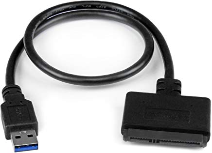

I'm wondering what is the point of an enclosure for a SATA SSD. Isn't the SSD already "enclosed" in that it doesn't have any exposed circuitry like mechanical drives?
This type of connector works fine:
