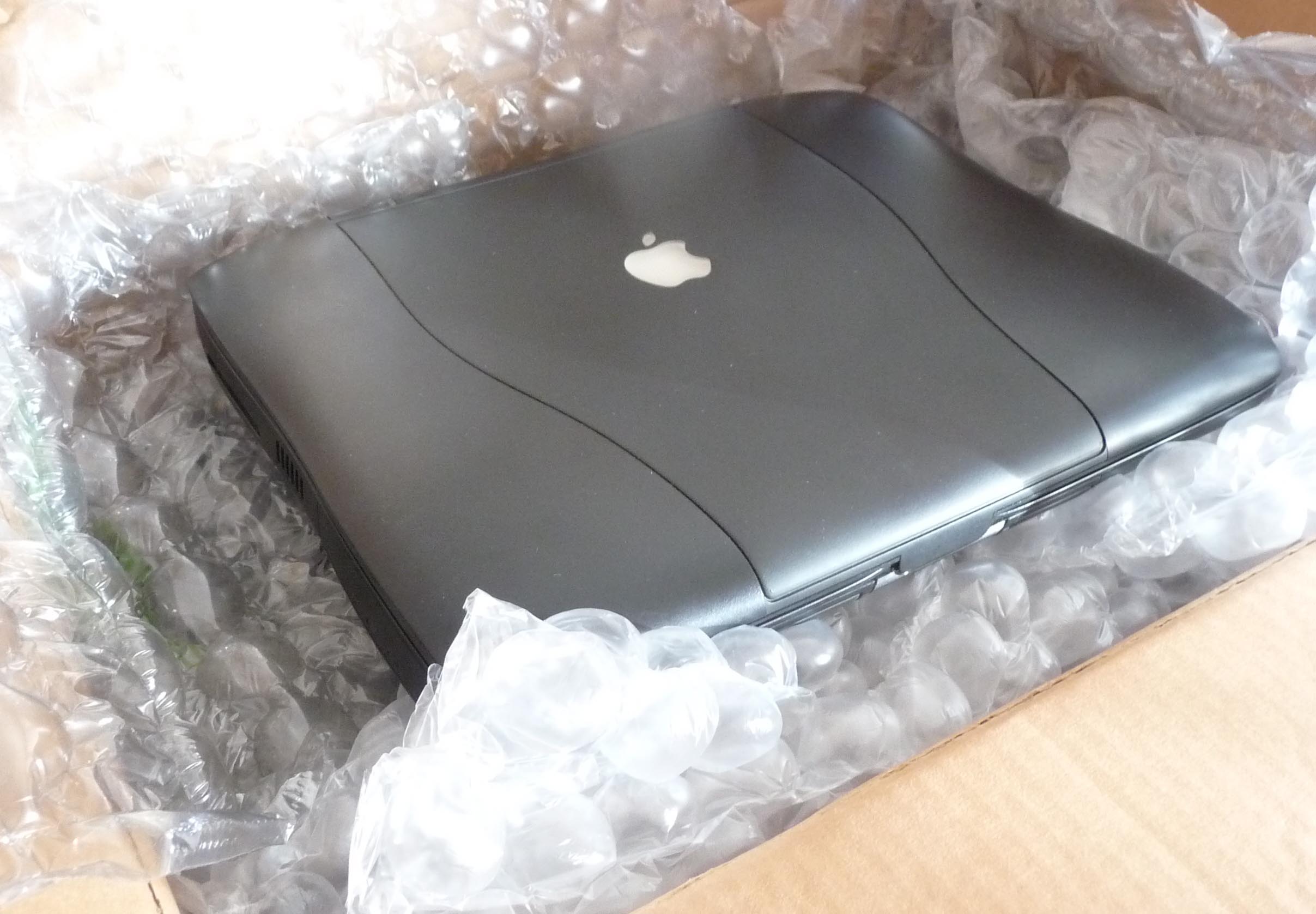

It's here. Arrived today! Looked very good in the ad that was posted, and the condition was even nicer than I could have imagined. A few blemishes on the palmrest which I'll hopefully get used to.
Still amazed that I was able to find a good one so rapidly.
Here are two quick photos on un-packaging. Will detail a few more over the weekend, together with my initial reactions after booting, and my 1st Pismo hands-on experience.
Many thanks to both of you for your inputs, which certainly guided this purchase.

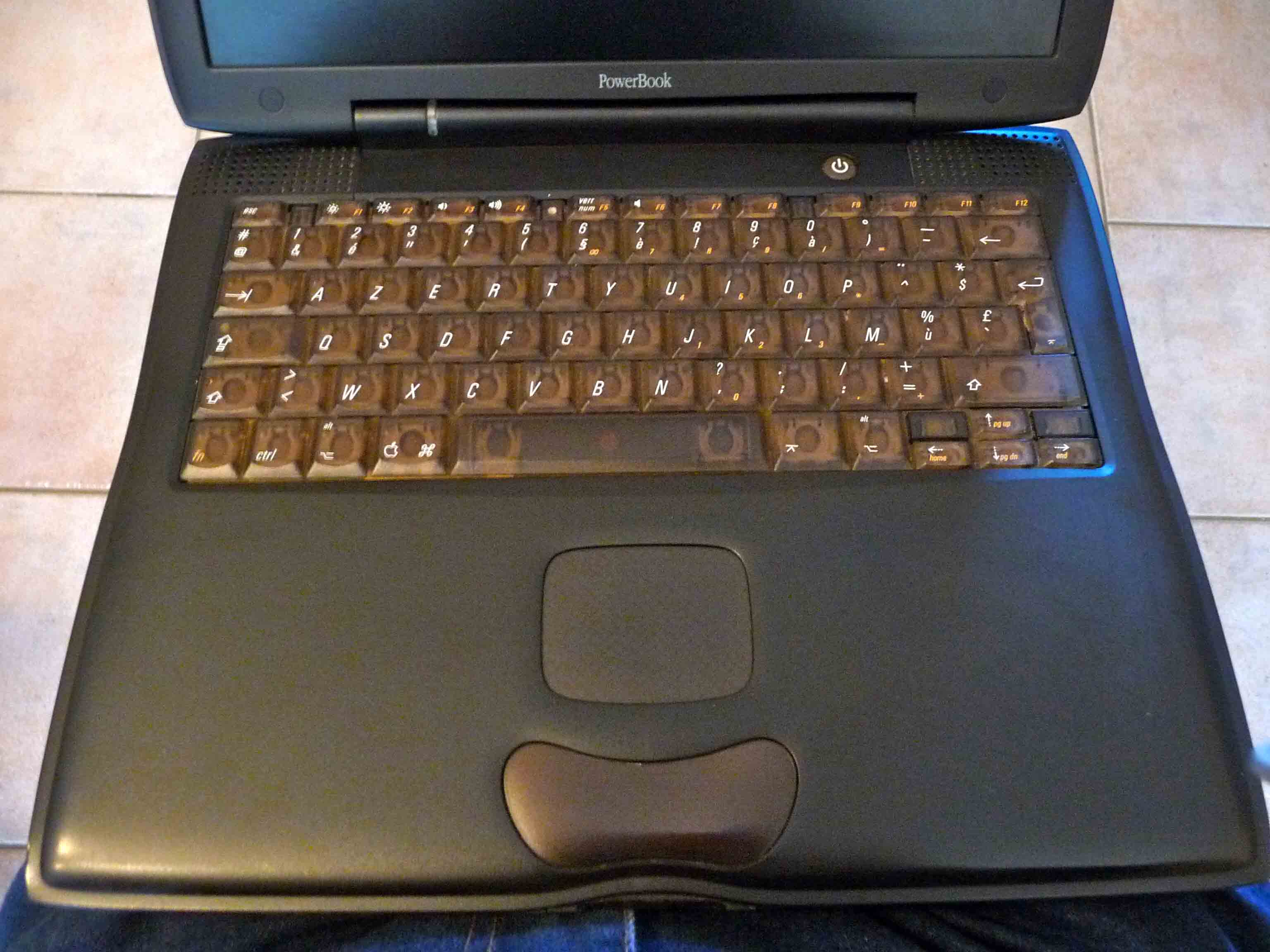

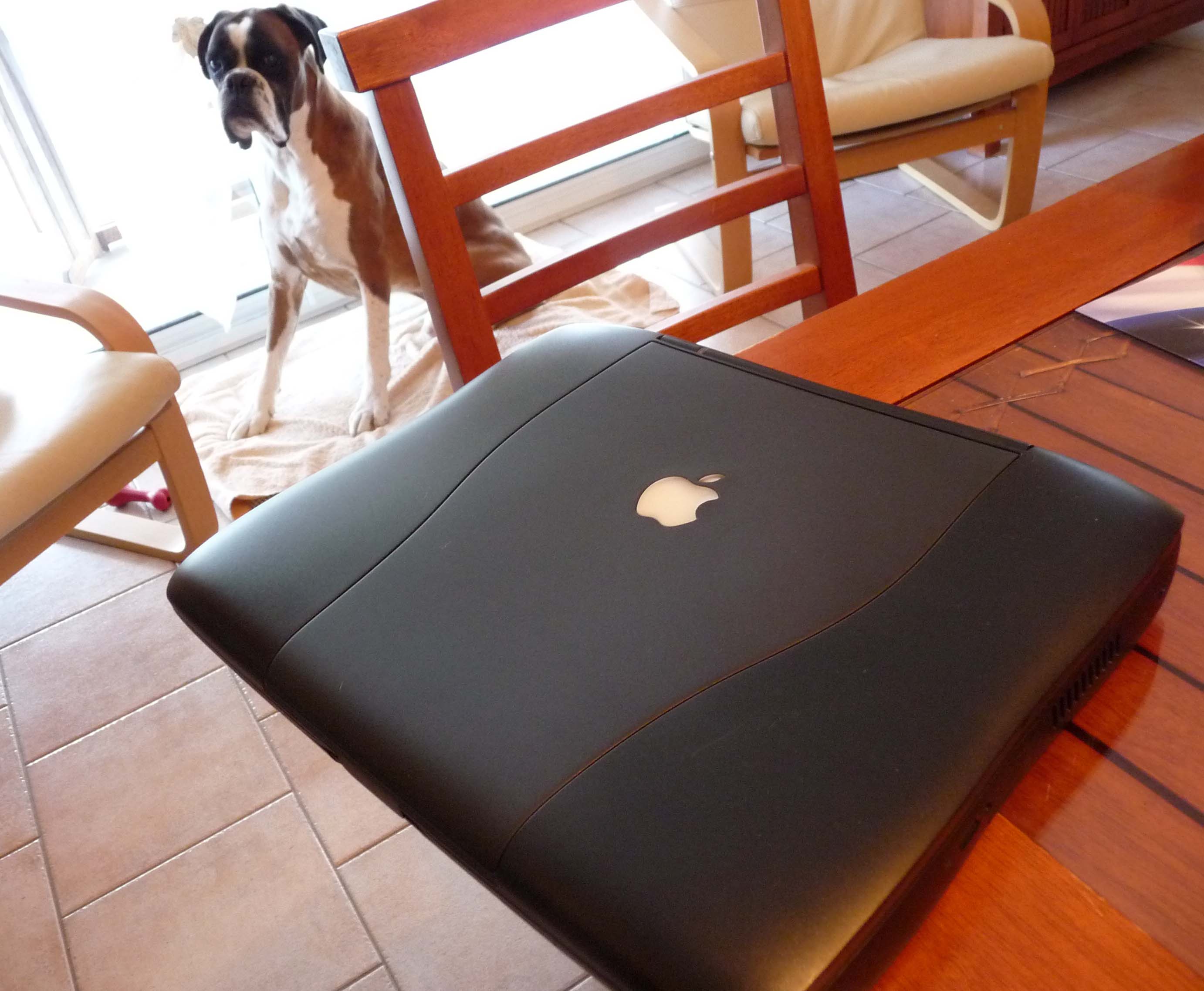

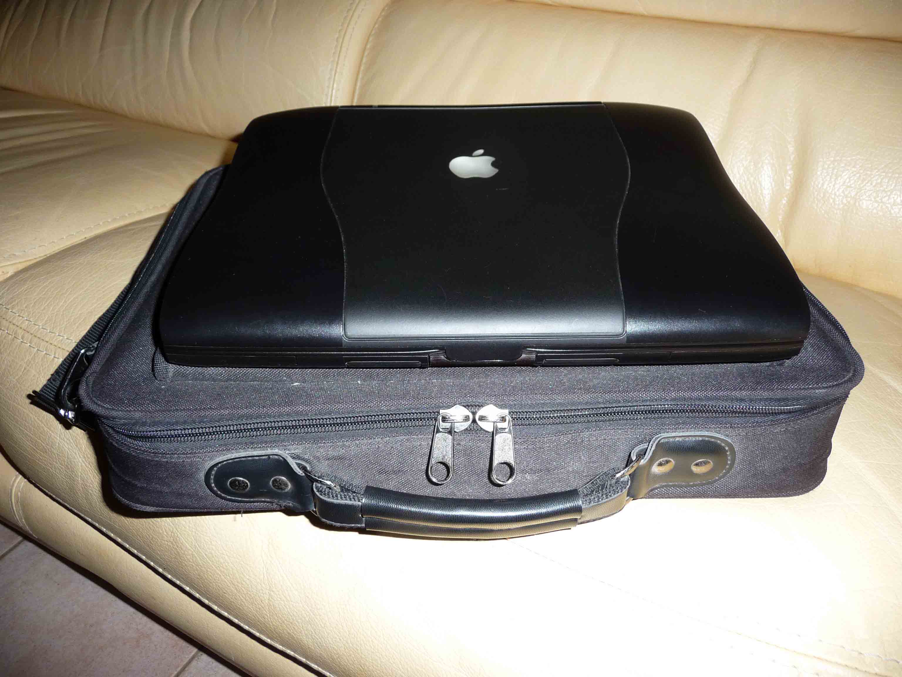

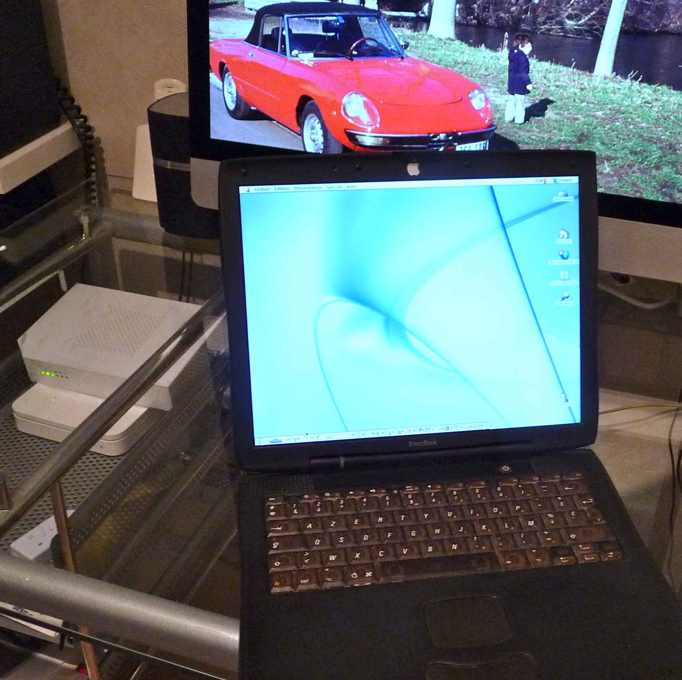

After a quick clean (it really didn't need much), here are a few additional photos below.

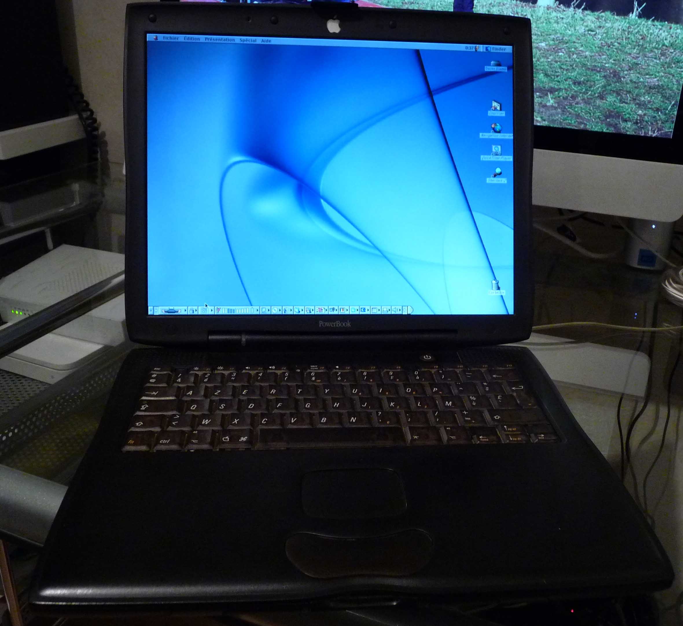

Have now tested it, and everything functions beautifully, even the HD (IBM 4200rpm) is amazingly quiet and appears pretty rapid.
I unplugged and re-made the PRAM battery connection, and so far have 4 green lights on the indicator, so I may have a reasonably serviceable battery too.
I have just removed the lower 64Mb RAM module, and installed 256Mb to the same location. The upper held 128Mb which remains until I can purchase and add 512Mb to both.
Think I'll wait till max RAM is installed before installing OS Tiger.
- OS 9.0 was found installed. Are there notable benefits or bug fixes in raising this to 9.2?
- Regarding RAM. On Amazon.fr who I would normally buy from, I noted that 2x 512Mb sticks were listed at more than I paid for this PISMO! This was ArchMemory brand (never heard of them) with life warranty, but methinks not cost effective. At the other end of the scale is Komputer Bay brand (anyone with any experience of this?) which is pretty cheap and also listed as having life warranty. Kingston may also be available, priced between the other two, so maybe the best bet.
-Regarding upgrading to a 7200rpm drive, I like the idea of this. Could anyone please recommend a precise make and model?
You can probably guess, that I'm enjoying this new toy immensely.
Cheers
