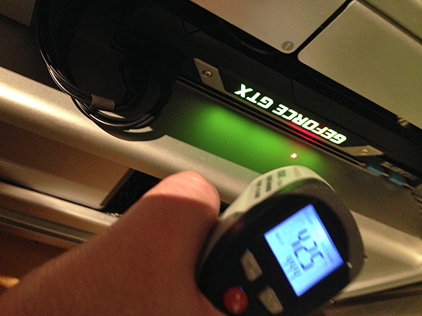

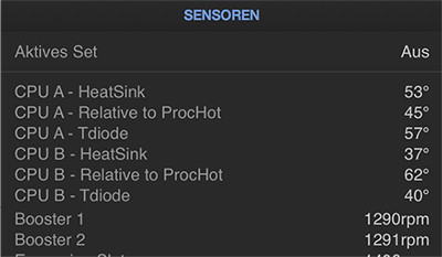

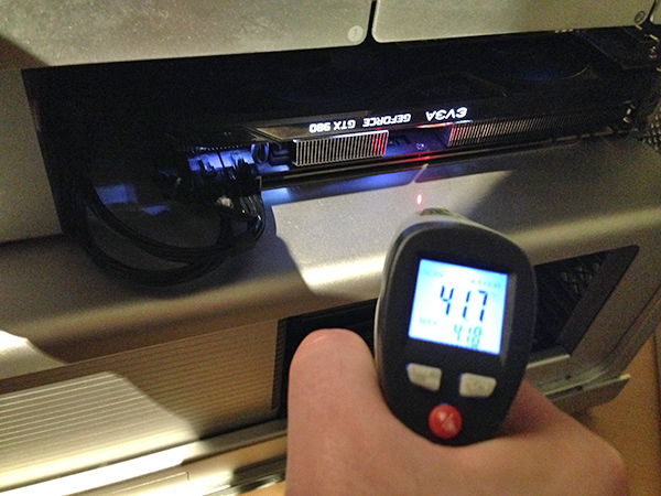

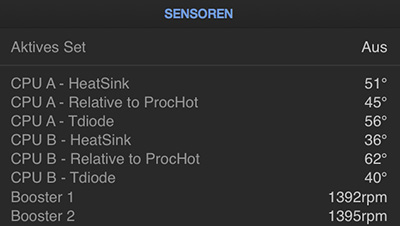

If you dont know it, test it:
For every card the same, 15 min Heaven, side door closed (only open for a short measurement)
Titan X blower
980 ACX open fan
Booster speed was a little bit higher at this moment, but temps are nearly the same.
Other than 250W vs 165W, the booster fans are already working harder with the open cooler.
PCI cooler was working harder (+400 rpm), but the booster fans are nearly identical. +/- 100 rpm
TitanX vs 980? 250W vs 165W?
Titan is using around 187 Watt at testing. You are right the Titan has a higher TDP, but the test shows blower or open fan has nearly no effekt to lower areas of the case. The PCI-Area fans a spinning faster but only really small changes in CPU-Area.
Perhaps 15 min is to short. I will test it again for an hour to get more heat to the case. But not today (i need a powercable first)

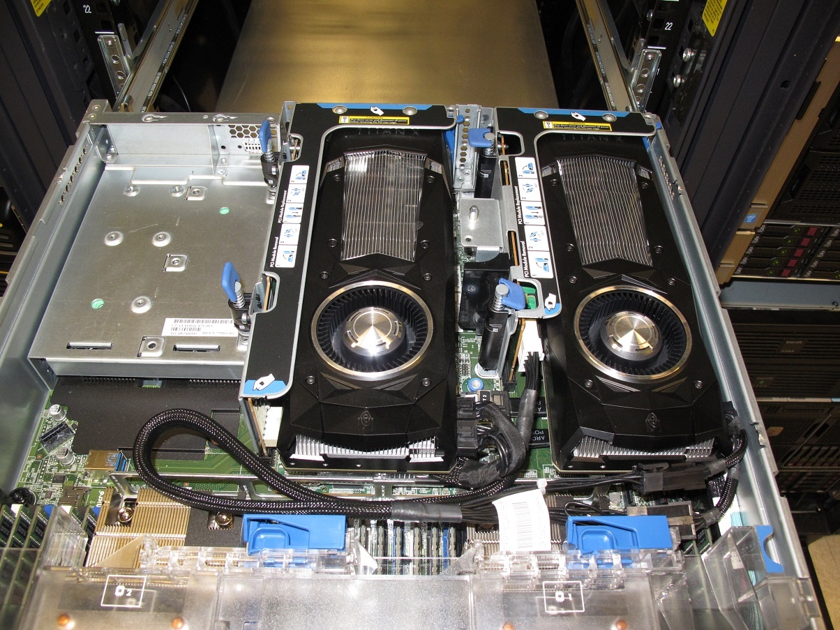

Note that most of the "blower style" cards do in fact circulate case air.
Look at these Titan X Pascal "Founder's Edition" cards:
On the closer side, the blower is pushing air over the heatsink into the interior of the case. On the far side, the blower is pushing air over the far side of the heat sink out through the bulkhead.
If you want to keep the GPU heat out of the interior of the case, get a fanless card.
