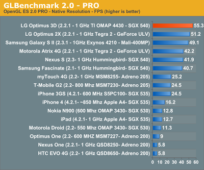

You make it sound like Apple is the only one playing that game. They aren't. Samsung had proudly announced their Galaxy S phone was "at least three times the power of other smartphones" yet in actual games it wasn't anywhere near that.
Also it's very difficult to predict how fast these chips will be just based on the GPU spec sheet. Here's a case in point
There are other benchmarks done at Anandtech but the results are similar. Despite using the "older" SGX540 GPU (same as the Hummingbird), with its higher clock speed and faster memory the OMAP 4430 beats everyone else on the chart, including Tegra2. There are just too many variables and the real test will be how the developers achieve the end result. And Apple has an upper hand there by default.
