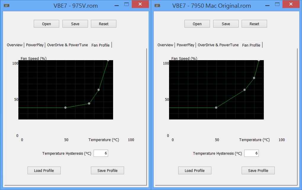

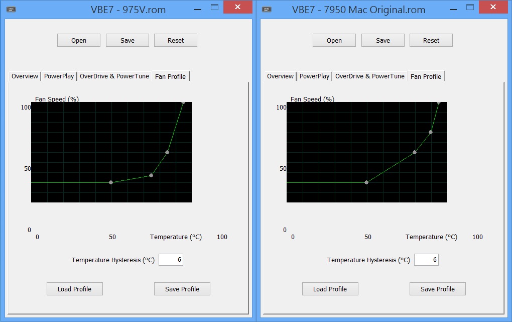

Here are some screen captures to let you have a better understand about the fan noise.
The LHS fan profile is the profile that I am now using. As you can see, it's much lower than the native one (on the RHS) at temperature range 50-75C, but eventually will go back up if the temperature close to it's design limit.

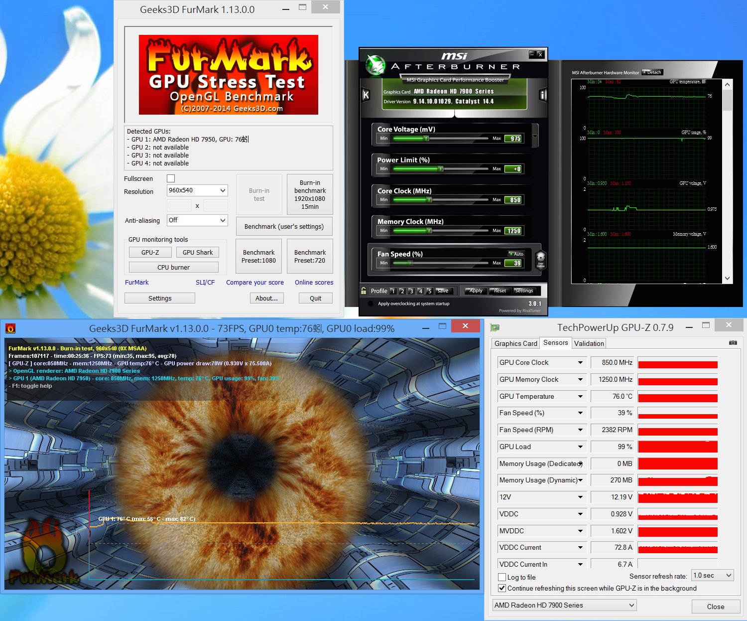

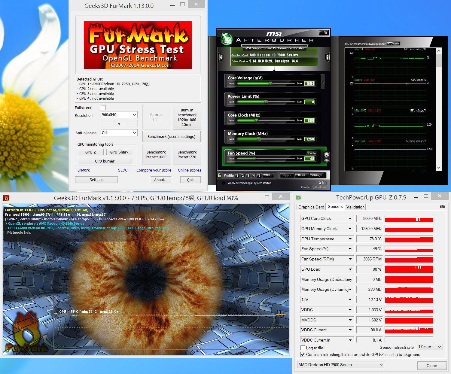

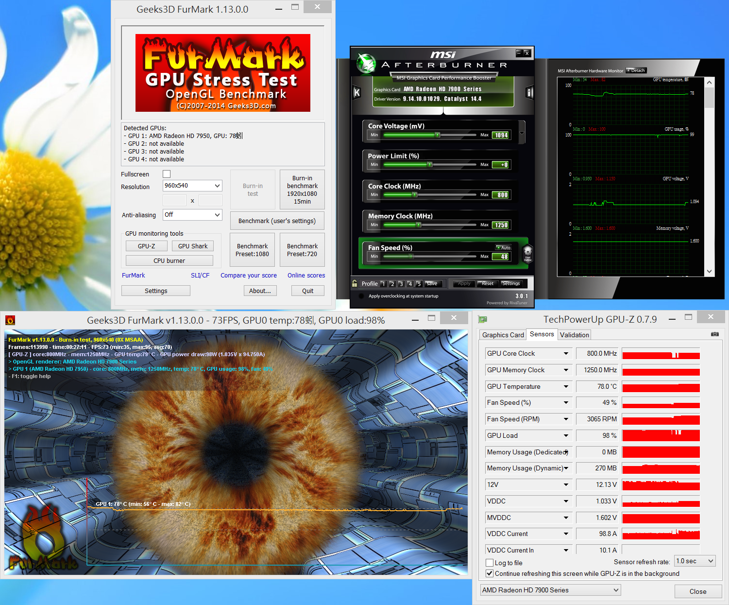

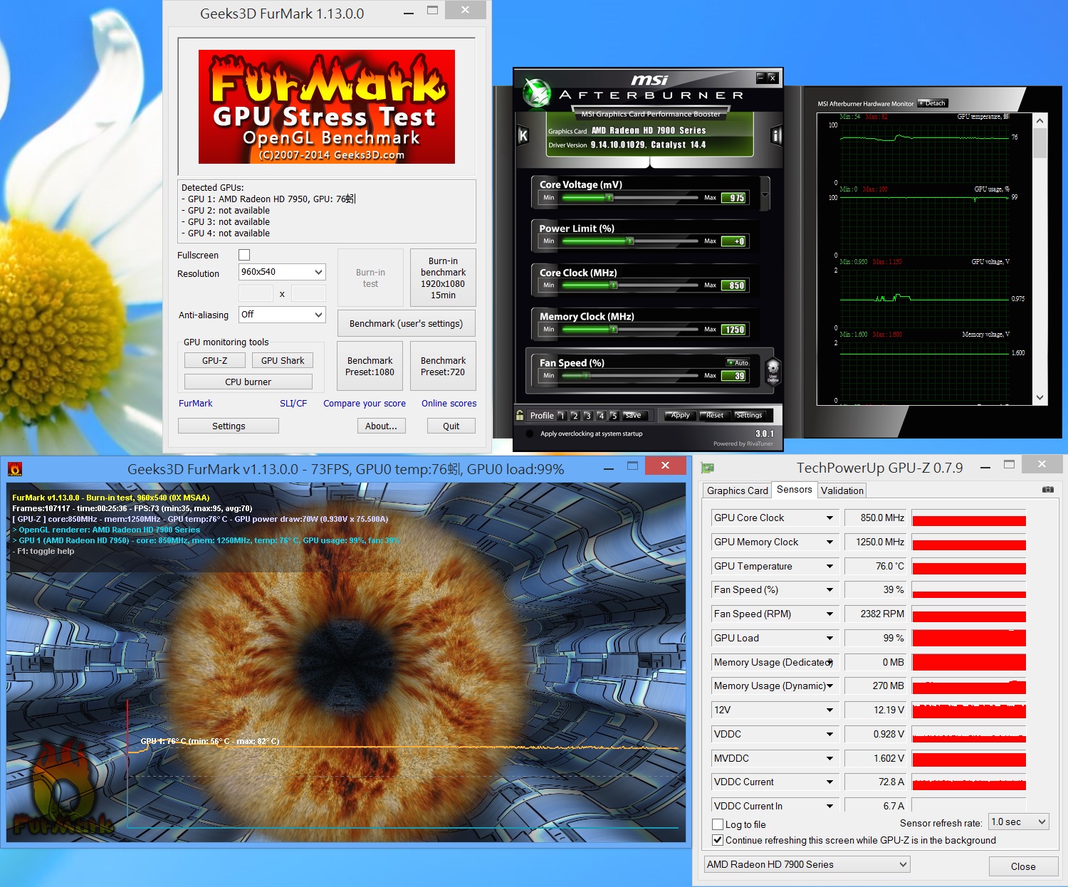

The following screen capture shows how your card react under full load when using the stock setting. As you can see, It score about 73FPS in Furmark, temperature stabilise at around 78C with fan speed 49% (3065RPM), and this high RPM create lots of noise.
However, this card don't really need 1.094V for that speed. I can reduce the voltage to 0.975V, and increase the core speed to 850MHz. It can still run perfectly stable. And now, it can score 73FPS in Furmark but temperature stabilise at 76C with only 39% fan speed. This 2382RPM still create some noise, but it's much less than 3065RPM.
In fact, this test is intended to stress the card to it's max stabilised temperature. In real world, the card usually run few degrees cooler than Furmark test even under full load. And that will make a huge difference. The native setting will make your fan run at around 3000 RPM. However, the calibrated fan will only run at about 2000 RPM, which makes a huge difference regarding fan noise.
You may play around with your PICe fan to simulate the noise difference. You can easily use smcFanControl to set your PCIe fan to 2000RPM, with this fan speed, you can clearly hear the fan, but not very loud. If you set it to 3000 RPM, the fan will be much louder.

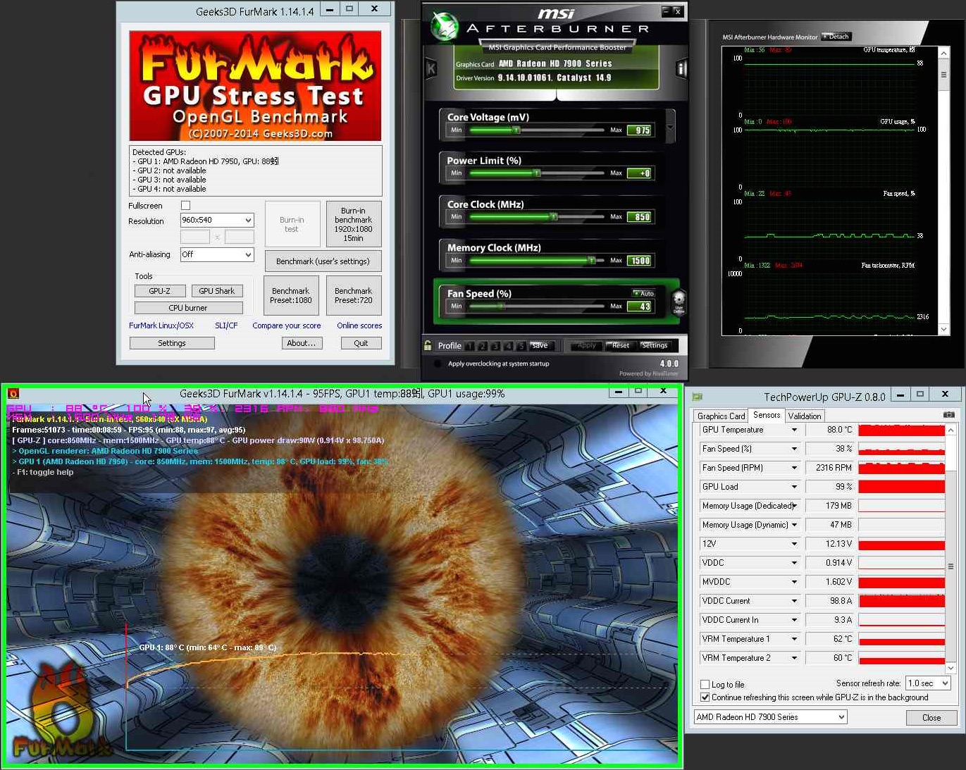

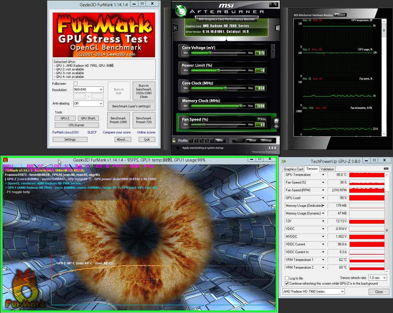

[Update 1: I further fine tune the card. Now it can score 95FPS under the same setting in Furmark. The temperature stable at around 88C (the max stable temperature for my card is 93C) with just 38% fan speed.
90W.jpg]
