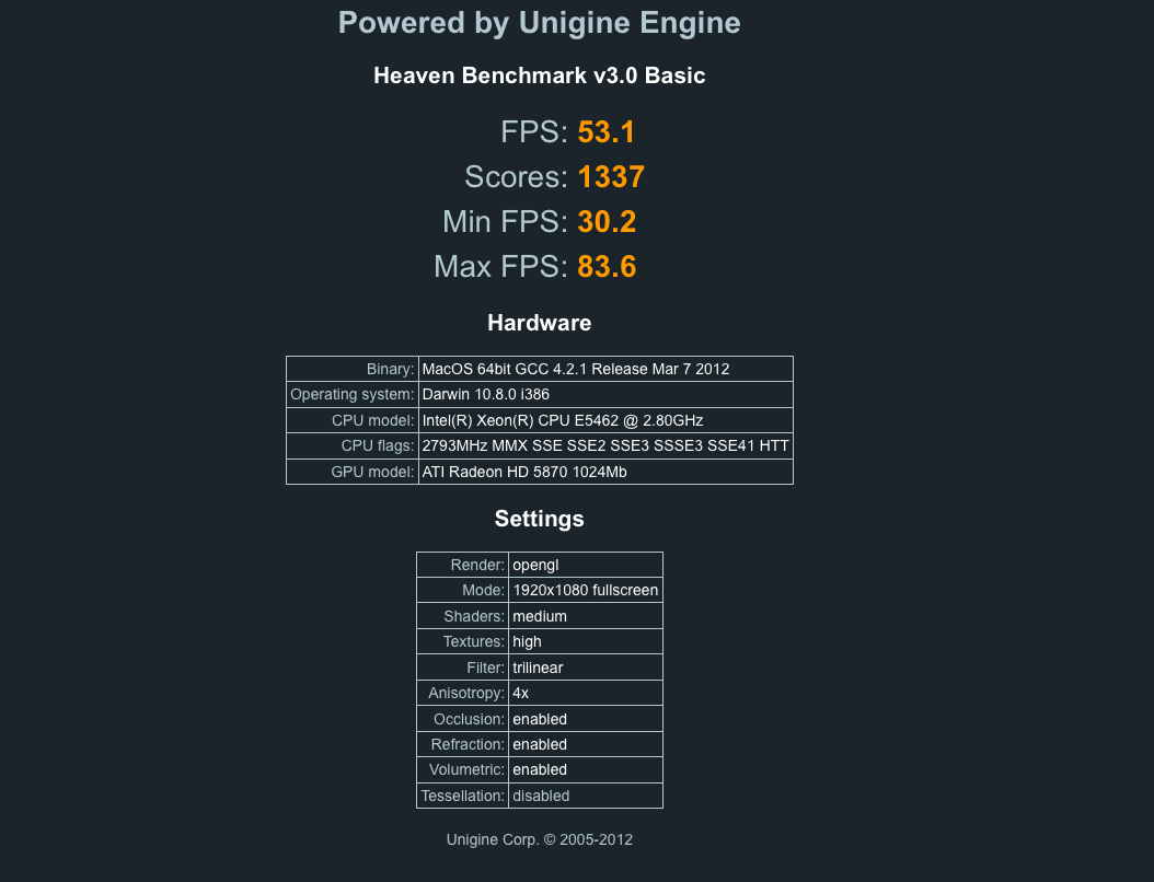

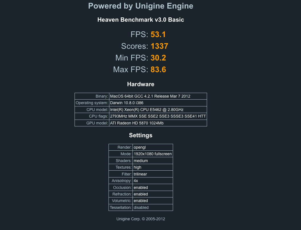

I'd like to know what performance I'm getting so I've downloaded EVGA Precision X and Unigine Heaven but I'm not quite sure how to run any tests. 😕
If anyone could give me some pointers that would be great.
Heaven is easy to run, install it and let it do a full run in benchmark mode with default settings and full screen. It will give you a results panel with a score like the attached one.
As you can see a 5870 is Leet in Heaven. Your 670 should trounce it. 😀
