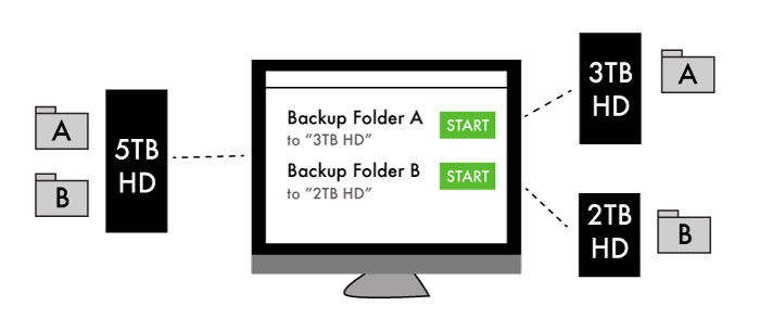

I have a 5TB external hard drive which I use to store media files on like music and videos. I don't have a large enough second harddrive to duplicate a direct complete backup, but I have a 3TB and a 2TB.
I was wondering if I could use software to split the files between the two backup drives.
I would like to set up a preference to pre-determine where I want the files to go (and only have to set this up once), so that way every couple of months I could plug in the backup drives and basically hit "start".

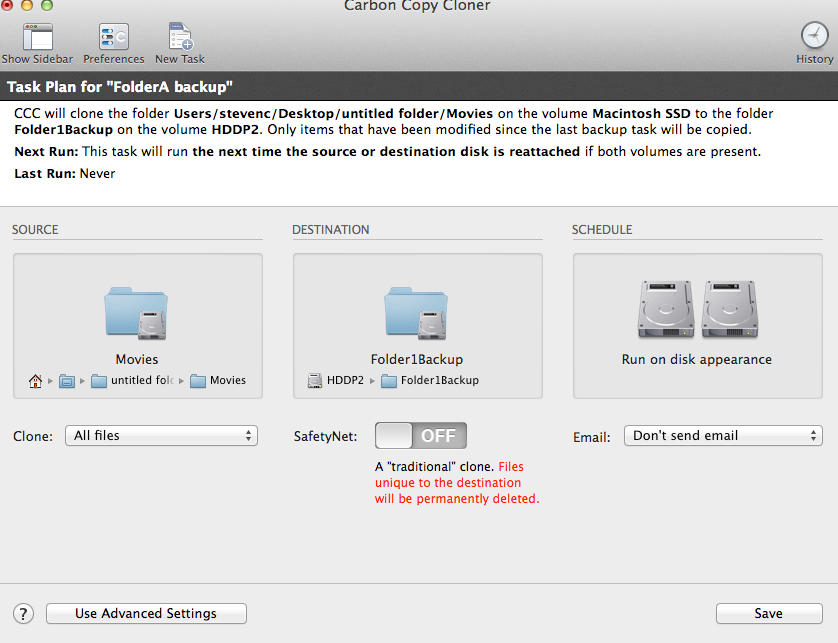

Carbon Copy Cloner
you can set source and destination and in the schedule specify that the backup only takes place when both drives are attached
so if the 5TB is attached and you plug in the 2TB it'll carry out that back up
likewise if you plug in the 3TB while the 5TB is attached

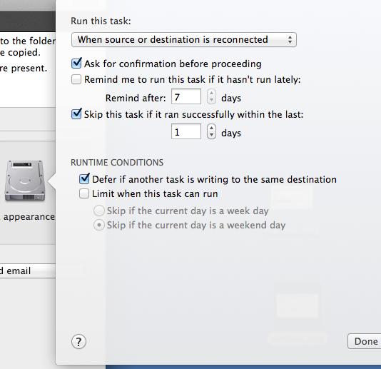

in both above back up tasks, you can have it prompt for confirmation that you want to carry out the back up, have it ignore you attaching the drive if you're attaching the drive again within x days since the last backup occurred etc
turn Safety Net option to off and it'll only copy files that have changed since last back up, and should remove any files from destination that are no longer on the source etc

+1 for CCC to do this. The whole thing can be automated and saved as a "task".
Just to expand a bit on what snorkelman said, you could setup CCC to copy folders A B C to disk 1 as one task, then folders D E F to disk 2 as another task.
