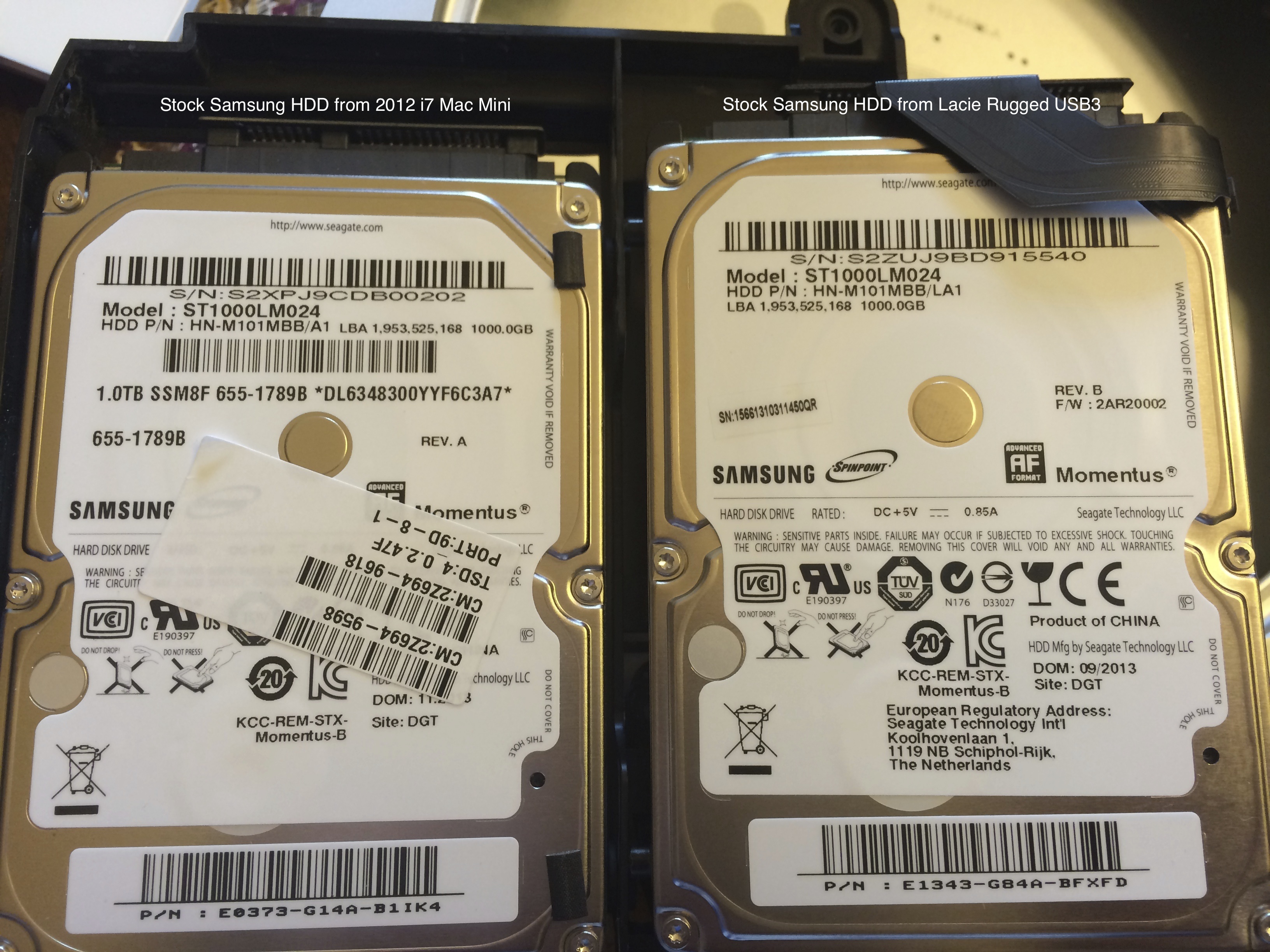

I recently put a dual drive kit in a 2012 i7 Mac Mini and have a pic of the exact 1TB inside.
Hope this helps you.

Crap, you guys are right, I checked it out - nevermind my original post.
I guess I was stuck on the hybrid drive thing, the FD is indeed two physical drives 'fused' via software, not a 2-in-1 drive like WD's and Seagate's.
