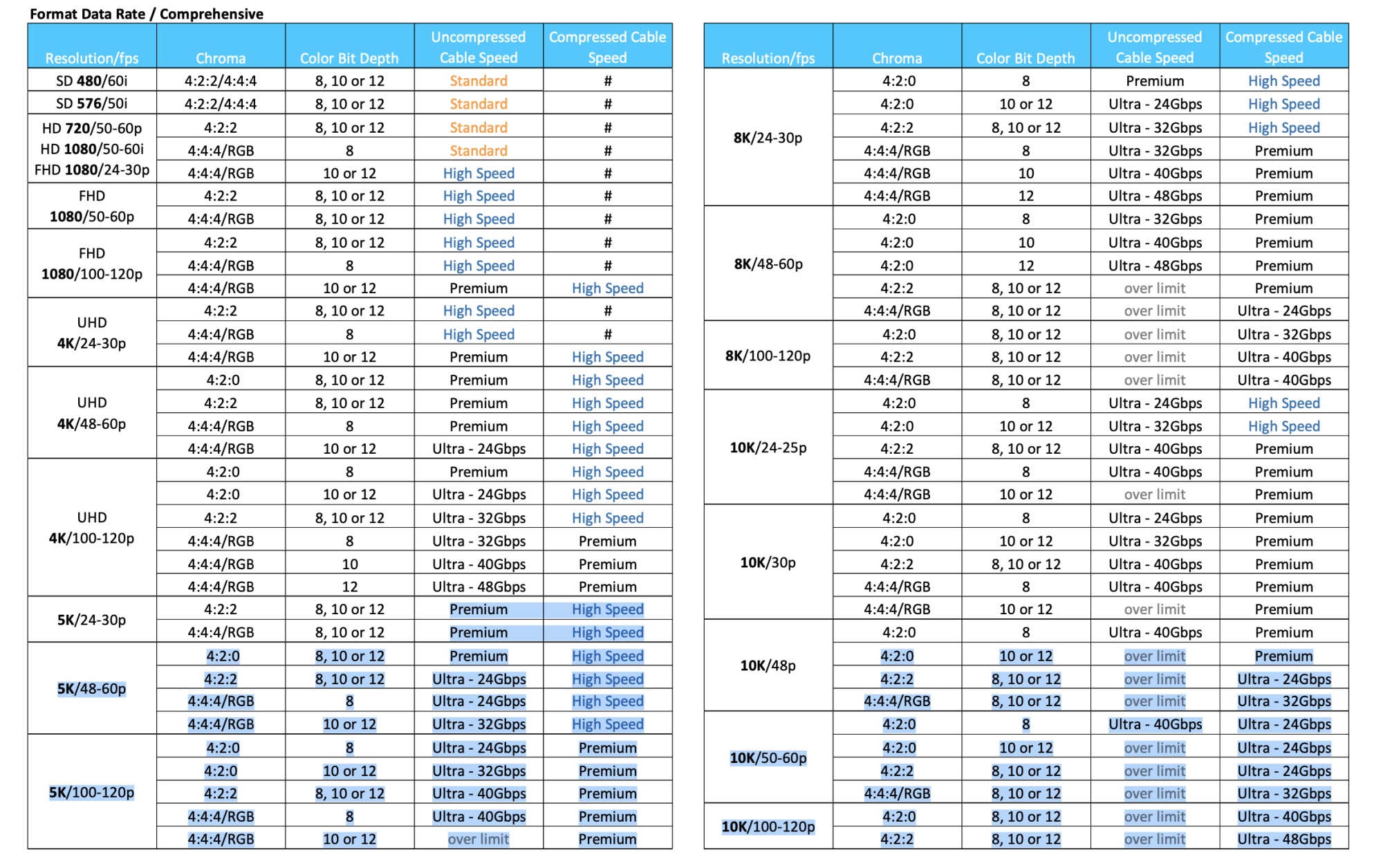

"With so many cable possibilities and requirements, it places the consumer in an electronic jungle faced with scores of options and little refuge. Current Digital Video television has up to four different resolution standards (2K, 4K, 8K, and 10K), a host of color attributes, and several different audio functions all requiring certain Published minimums (Figure 1). With so many different features available to the consumer the selection process becomes more difficult"

Nothing on the Apple TV 4K requires more than a 18 Gbps cable. Having a higher bandwidth cable isn't going to result in picture quality differences.
4K HDR at 4:4:4 colour depth requires more than 18 Gbps. It also helps to future proof for the next ATV version.
Reactions: leifp
4:4:4 10bit is not a part of the HDMI 2.0 standard and Apple TV doesn't actually support HDMI 2.1 fully so again you don't need a higher bandwidth cable.

Yes, but not 10bit which is what would use more than 18Gbps. Again, more than 18Gbps cables aren't needed. You can use one just fine but it will not result in any bit of difference in quality.

AppleTV definitely supports 10 bit video. Here is a copy of the supported video formats cited in my earlier post taken from Apple's web site. Dolby Vision, HDR10+/HDR10/HLG with HEVC (Main 10 Profile) all have 10 bit Codecs.

10bit support for 4k60 requires HDMI 2.1 which the Apple TV 4K doesn't support (other than earc) though they claim 2.1 support. It is unfortunate that companies are allowed to claim HDMI 2.1 support when they don't truly support it but it is allowed for some reason.
