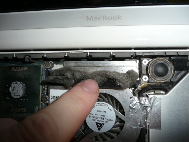

Since December 2010 the macbook began to get overheat (turned off) from time to time and two month later it crashed quite every time I streamed a movie. So I cleaned the fan - without success. Fortunately I didn't give up and removed the heatsink the next day. Big surprise: a big chunk of dust that stopped the whole airstream. To make it short: the macbook is running stable right now.

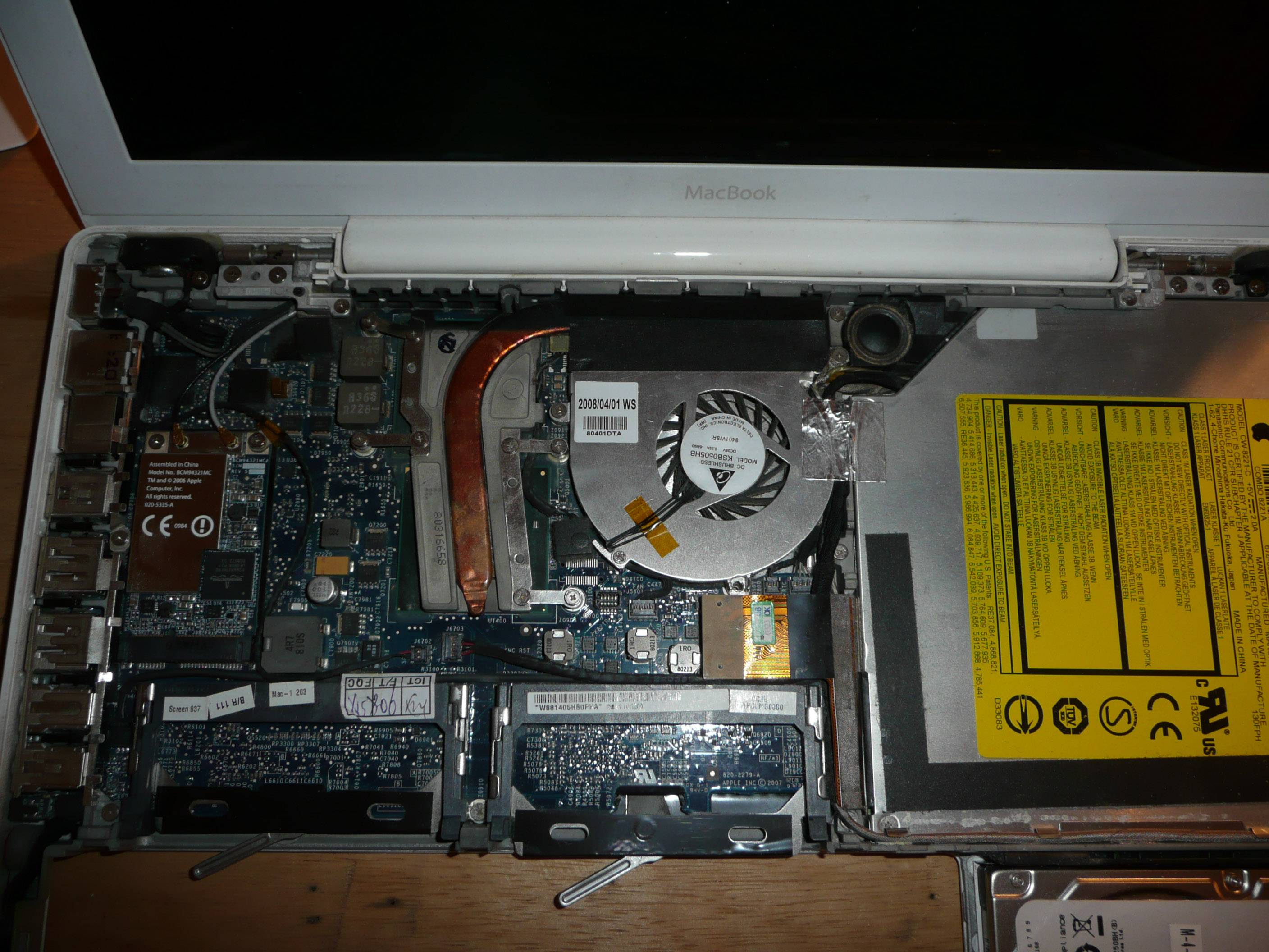

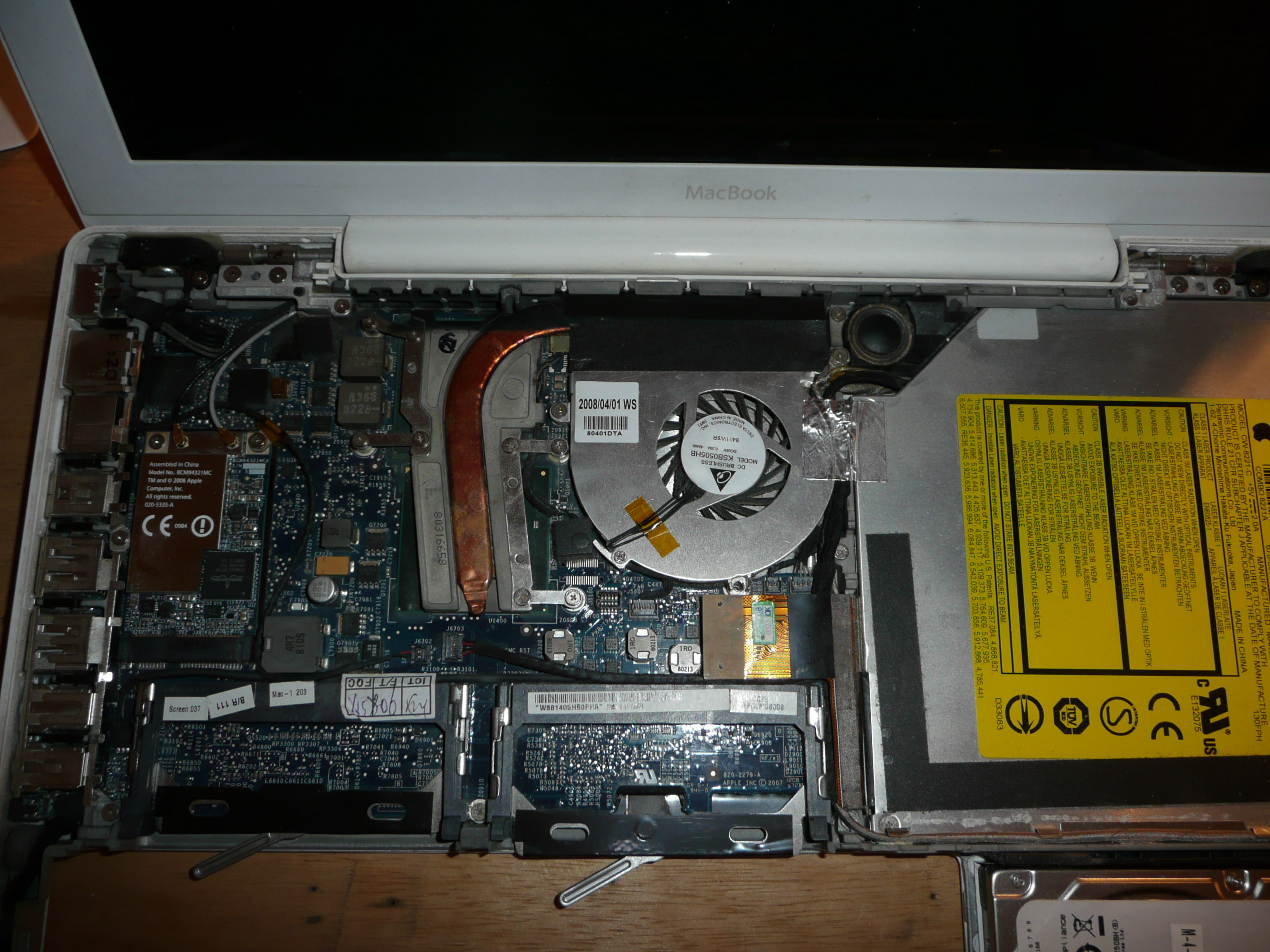

I suppose that I have horizontal connectors, but I contacted an ebay-vendor (http://cgi.ebay.de/MacBook-A1181-He...715?pt=LH_DefaultDomain_0&hash=item5641086933) and sent him a picture of my open macbook. He told me that he doesn't have the part that I need for my macbook.

From what I've read the original MacBook, late 2006 and Mid 2007 all have the same heatsink. For the best explanation, go to iFixit.com and read the take apart guide on the MacBook's and in the pictures it shows the difference between the heatsink designs. For comparison, here is a picture of my Mid-2007 Merom MacBook.
You should be able to get the fan on its own - it is connected by sticky tape to the heatsink.
The later Santa Rosa/Penryn MacBooks have basically the same fan as the earlier MacBooks but with a different connector to the logicbord.
What you need for the Penryn is the horizontal (flatblade) type.
similar to this one http://cgi.ebay.com/APPLE-MAC-CPU-FAN-DELTA-BSB04505HA-ADDA-AB5605HB-RBB-/400120350624?pt=Apple_Laptops&hash=item5d290807a0
The fan is cheap enough but postage to Europe (where are you located - Germany ?) is not cheap....

my macbook is an early 2008, as far as I know.
I learned from ifixit how to remove the heatsink, but they talk only about differences regarding the number of temperature sensors (Step 15):
http://www.ifixit.com/Guide/Repair/Installing-MacBook-Core-2-Duo-Heat-Sink/524/5
Is this the "connector"?
If so, it looks like I have the horizontal one, but I'm wondering why the ebay-vendor won't offer me his item.

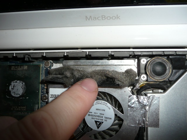

Find attached a picture of the removed dust bunny.
