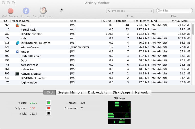

Jerwin, the kind of documents I scan are generally textbook about physics or maths. Like your document, they may contain between 300 to 800 pages. And are scanned between 200 to 300 dpi depending on the quality of the print.
Concerning the speed of ocr, it takes for example 4 hours to convert to searchable pdf a document of 775 pages and 280 MB. The converted file's size is now 410 MB.
During the ocr, devonscribbler used 100 % cpu as can be seen on activity monitor.
Kohlson, on my computer the system is on a ssd with 170 MB/s in writing and 240 MB/s in reading speeds. It seems that only one core is used during the ocr process.
