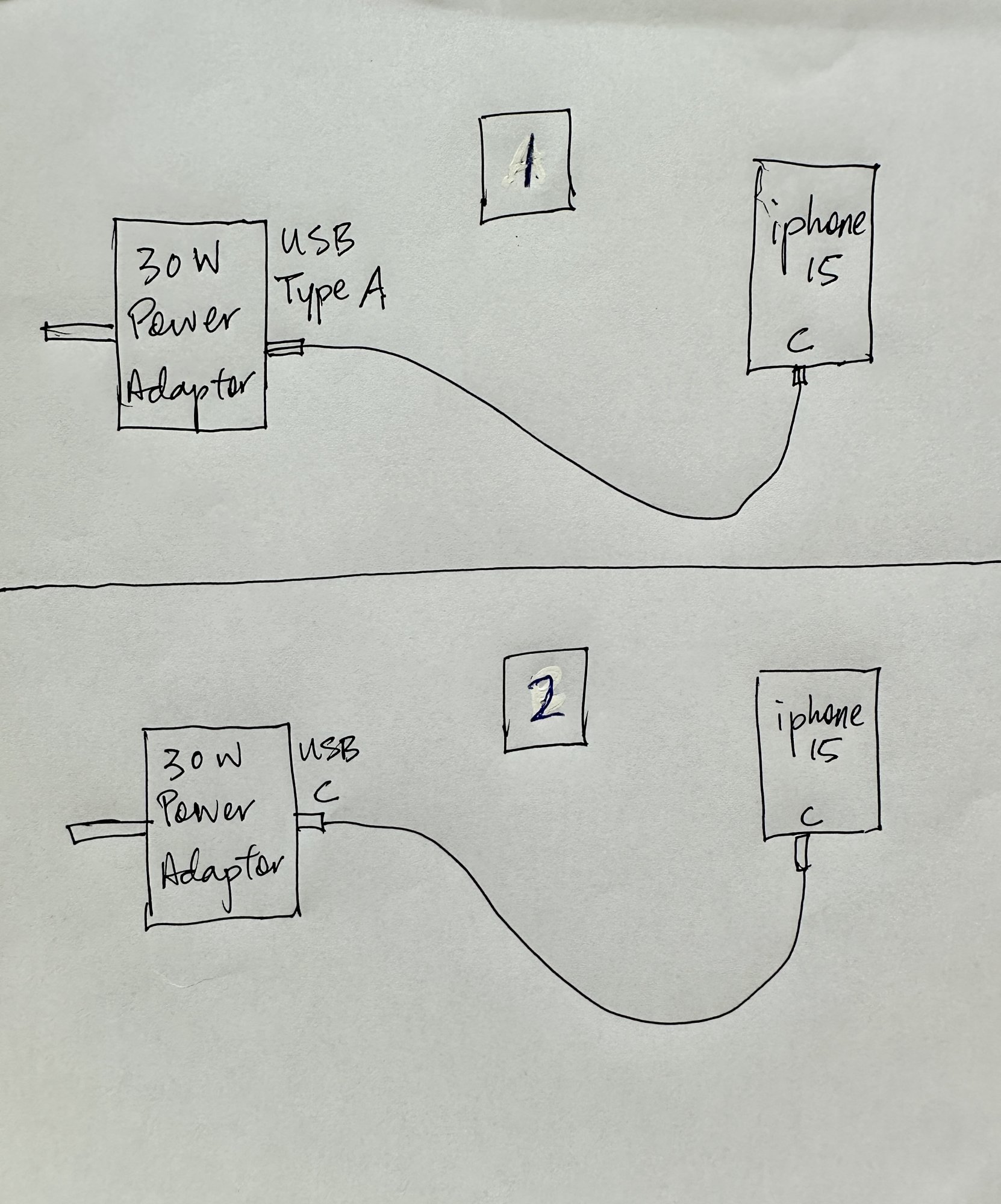

I intend to buy a 30W power adaptor (see image). I know a 30W power adaptor will not charged more than what the iphone can receive at 20W as it will self regulate (this what I hv read). I intentionally buy a higher wattage for future proofing.
Which option will charge faster. Option 1 (A to C) or 2 (C to C) assuming both charging cables are of same quality. Does USB Type A 2.0 or 3.0 make a difference as it is not stated in the product. Or it hv no effect as this is not for transferring data. Sorry I'm quite noob in this.

Charging using USB-A is typically limited to 12 watts, even if you use a USB-A to USB-C cable. That's just the standard spec for USB-A (max 5 volts * max 2.4 amps).

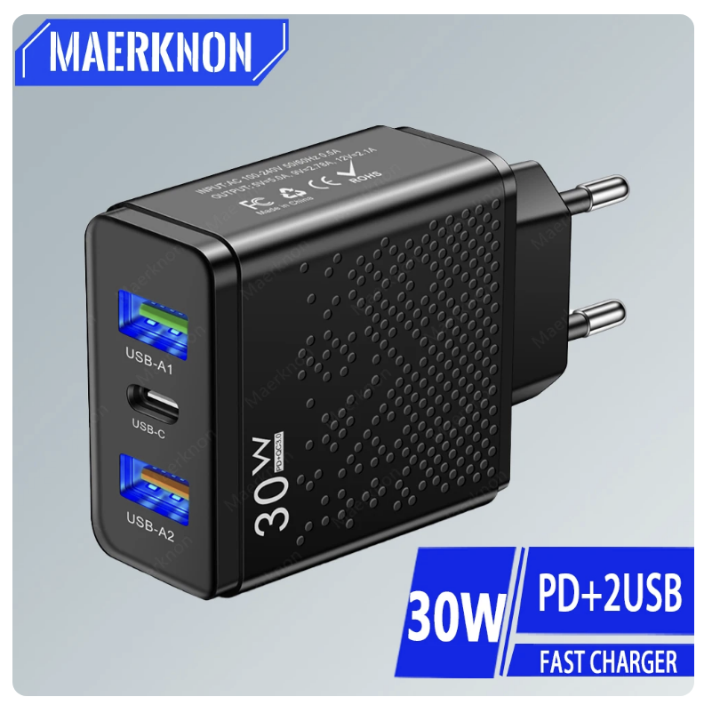

Supposedly this one has QuickCharge 3.0 for more wattage/faster charging using USB-A, but iPhones don't support QuickCharge so it'll charge slower. Only devices that support QuickCharge will charge faster.
It looks like this is just a cheap charger from AliExpress with hardly any technical information listed, so who knows what it's actually doing. Personally, I would stick to well known/trusted brands.

Quick Charge is a technology developed by Qualcomm to get past the 12W limit that USB-A has. To make use of it, the device you're charging also needs to support it. Apple Devices do not support Quick Charge, so they just use the standard/slow speed when using a USB-A charger.
If you were to charge your iPhone using the USB-A port on this charger, it's only going to charge at 12W or less. To get more wattage to charge faster, you need to use a USB-C charger.

ah ok I think I get it.
So even though the power adaptor has two ports, a USB A and USB C rated at 30W, the A will only gives out 12W whereas the C will gives out 30W but iphone 15 will not receive 30W anyway but at 20W as it regulates itself at 20W limit. Is that correct just to confirmed my understanding?
Yeah, pretty much. Couple things though…
The 30 watts is most likely shared between the three ports. If you charge two things at once, the wattage could be split into something like 12W over USB-A and 18W over USB-C. Again, there's no technical information listed, so we don't know for sure how this particular charger is handling it.
Also, the iPhone 15 actually accepts up to 27W of power. 20W is just the common/basic charger Apple sells.
