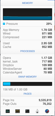

jetlife2, you have asked a rather complex question as there are a few ways of measuring memory usage. Anecdotally I can say that Yosemite and El Capitan are more "memory" efficient than Mavericks. If you are asking which OS will have less spinning "beach balls" that is different as that is dependant on CPU speed as well as RAM and the type of drive in use HDD or SSD. The best benchmark for measurement is Memory Pressure. Here is a pic of my Memory usage running this browser only.

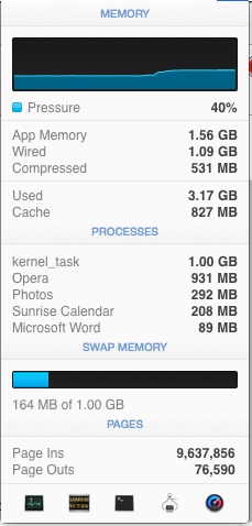

And here is the same system running running this browser, MS Word, Calendar and Photos.
You can see the difference is not great but notice background tasks and kernel_task changes. What I am saying is that your question cannot be answered in the simple terms of one value. I am running El Capitan with a
