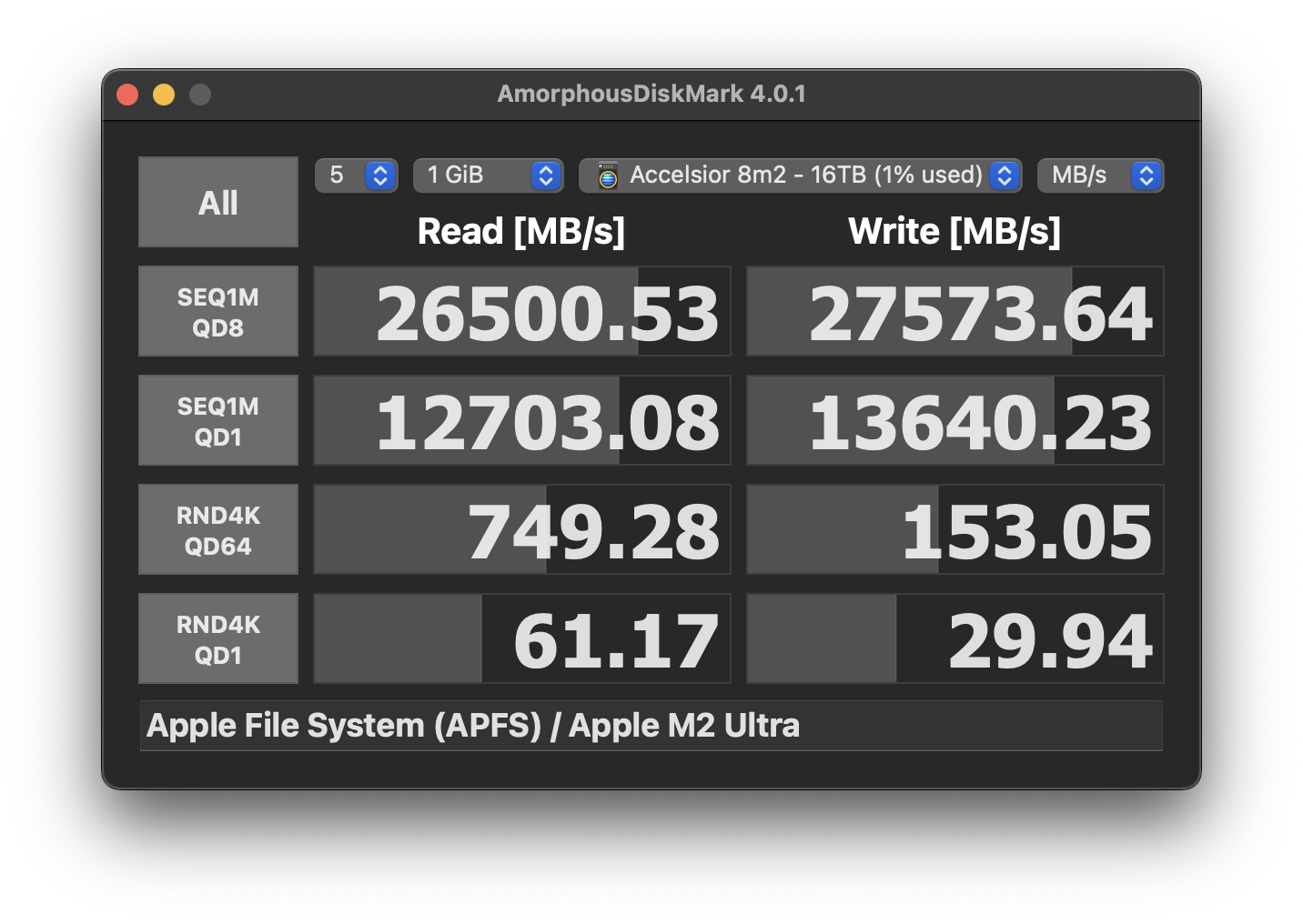

Here is a screen grab of the performance! Insane!
Must have missed that you can order just the card. I think I’ll give that a try. Those speeds are insane. Obviously I won’t get those till I upgrade the computer at some point but regardless I’ll be way faster than the Pegasus raid I had in there and see as that wouldn’t work in a new Mac Pro it had to go.
