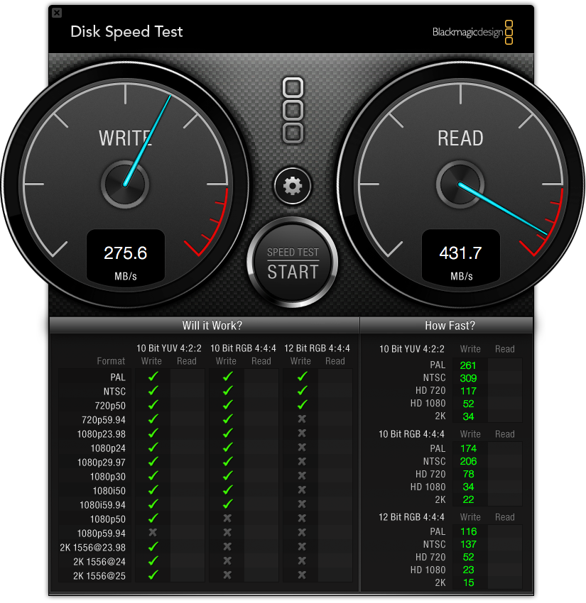

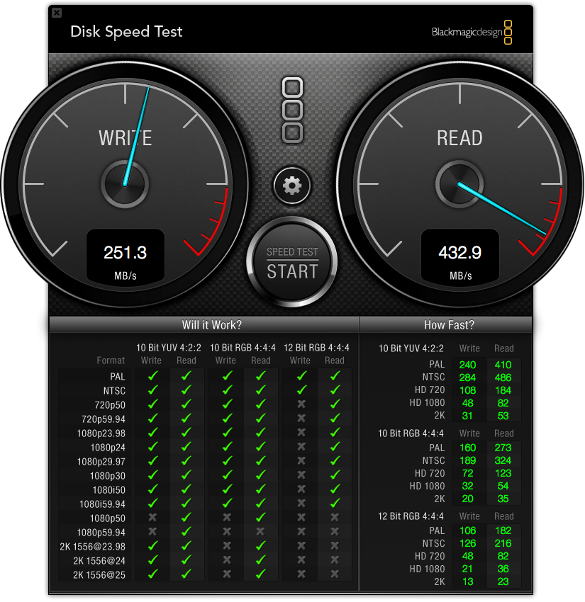

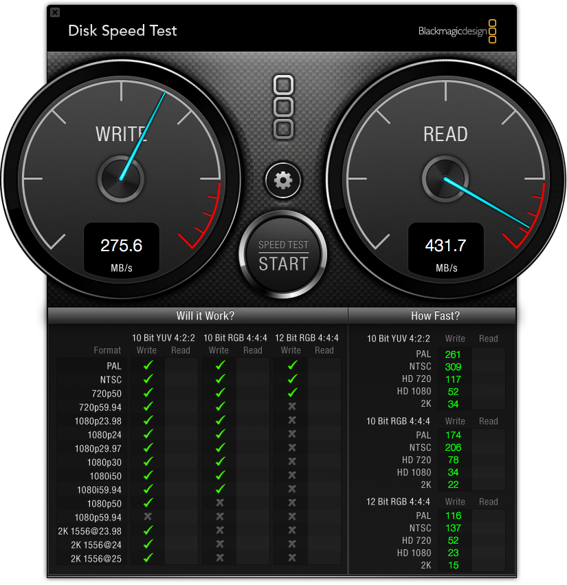

I've been booting and running my late-2012 Mac Mini since January 2013 via an SSD mounted in a USB3/SATA docking station.
That's just shy of FOUR YEARS of usage.
Often the Mini is turned on around 9.00am and left on (I don't put it to sleep) until midnight. It's been used heavily.
I've used two drives with it, the first an Intel 530 series, and the current one a Crucial M500.
Following are two benchmarks of the Crucial drive.
The first was taken on the day of installation (March 2014)
The second was taken a few minutes ago.
Crucial Speed 12:15:16.png
How much has the drive (in ActionableMango's words) "bogged down"?
Use your own judgement.
If I repeat the test a few times, write speeds will jump back up to over 270mbps.
Read speeds are as fast, or a hair faster, then when new.
The read speed of about 430mbps seems to be about the maximum throughput that can be obtained via a USB3 connection (others have reported essentially the same speed after installing a USB3 SSD). Of interest is that "aging" doesn't seem to change it at all.

No USB attached SSD is going to work with TRIM under macOS. Here is an earlier comment of mine that explains a bit with an article linked at the end.
You are correct. USB cannot pass along the SATA TRIM command.
What some people have read and it has caused confusion, is some UASP (USB-attached SCSI protocol) enclosure chipsets can convert the SCSI Unmap command (similar to TRIM) to TRIM commands at the drive. Windows can run this SCSI Unmap command with the Powershell command Optimize-Volume and the -ReTrim option. OS X cannot run the SCSI Unmap command (at least not that I have been able to find). So at this point, no matter what chipset you use, you are not going to get TRIM over USB on a Mac.
The first was taken on the day of installation (March 2014)View attachment 678161 .
Fishrrman, my write results on my M500 drive is quite different than yours. My M500 is 480GB (size can make a difference). But as mentioned in my post #9, I got 382MB/sec write speeds on my M500 in a USB enclosure connected via USB 3 hub, versus 250-270MB/sec that you're getting. This was when the drive was new (in terms of writes, not in chronological age) and I'm pretty sure (but not absolutely certain) that I tested it on my 2012 (2.6 quad-core) Mini, not my 2014 Mini (based on where the text files containing the test results were). The M500 is in my 2014 Mini now so it would be pain to retest it. This is obviously not a TRIM issue. Compared to what I currently get (SATA) in the Mini - the USB was 87% of the SATA speed for the writes and 90% for the reads so I'm pretty confident that the USB benchmarks were not a fluke.
So if you have a 480GB M500, you might want to investigate to see if you can get higher write speeds (maybe a different enclosure - mine was under $20 but was purchased this past summer, yours maybe dates to 2014? or try it connected directly to the Mini to see if that makes a difference). Just a suggestion.
EDIT: Looking at how it compares to my 240GB Thunderbolt SSD, which supposedly has the internals of a M500, that would be more consistent with your results - which is 79% of the write speed, 85% of the read speed of the Thunderbolt-connected SSD.
