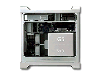

Well seeing that there's "one" shield of the processor. It's a first-gen single 1.8ghz PowerMac G5.
IIRC the earlier G5 models had a shield per CPU.
So, a Single 1.6 had only the lower "half" of shield shown below.
A Dual 1.8 or 2.0 would have looked like this:
Thanks for the correctin. I meant to say one shield with a single G5 printed in the middle. My dual 1.8 looked like the one you have pictured with 2 G5s over each processor. Also I think the later dual-core models went back to that first design to with a single G5 over the whole shield.

When the G5 was first launched only the 2.0 GHz was a Dual config. Both the 1.6 and 1.8 were singles, and thus had only the lower half of the shield.
After just a few months the Single 1.8 was quickly replaced by the Dual 1.8, which Apple should have started off with in the first place.
