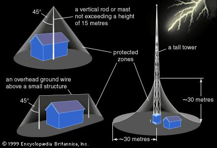

Did you know that the lightning rod height It is equal to the radius of its protection from the lightning strike..pay attention to materials from which it was made because if they will be not of the good quality you'll see how it it will rust in 3 years.

Some demonstrated protection. Lightning rods protect the structure because and only if lightning is connected to what does protection - earth ground. Protector only protects appliance if it also connects low impedance (ie less than 10 feet) to earth ground.
