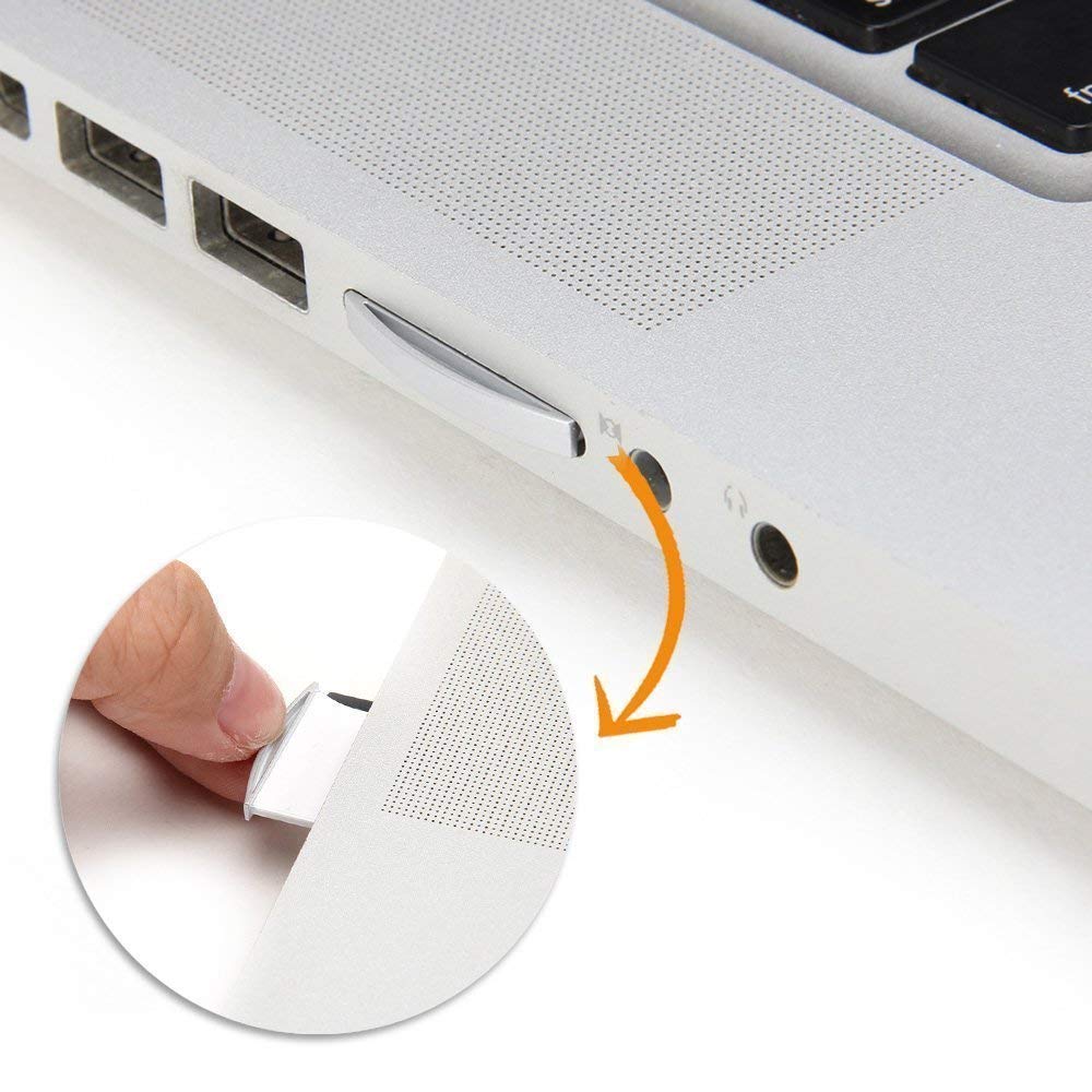

Looks like all 13" Macbook Airs between 2010 and 2015 have that shallow SD card slot.
This is an example of adapter that I'm talking about (and the one that I bought for my wife's MBA:
https://www.amazon.com/MicroSD-lycantant-MacBooks-Raspberry-Adafruit/dp/B01MT980QC/
[doublepost=1534522410][/doublepost]Looking at that link, it only supports up to 64GB, and 128 is the smallest I'm considering. It also says for Macbook - not Macbook Air, so I'm assuming your wife has a Macbook (or Pro), and those have a shallower bay, but that Macbook Airs are deeper.
In addition, looking at this:
https://www.amazon.com/aluminum-mic...534521945&sr=1-1&keywords=nifty+minidrive+air
it appears to be an adapter/holder for a micro SD, that is the same size as a non micro SD, and says it sits flush, so I question why you say "all 13" Macbook Airs between 2010 and 2015 have that shallow SD card slot." Where did you get that information?
If you're right I need something different than i thought, and definitely an adapter and a micro SD,
