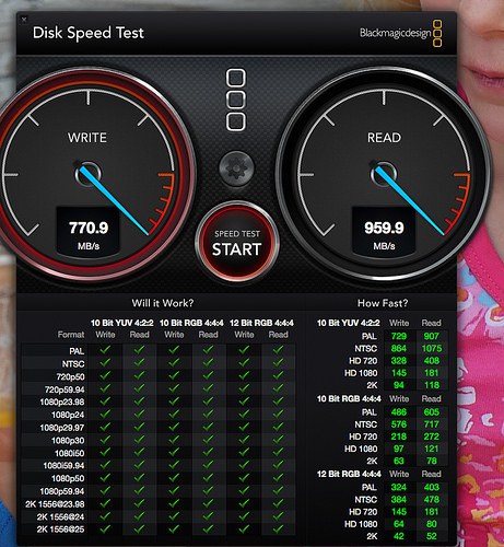

^^^^Not True!!! My Solo x2 BlackMagic test with a Samsung 840 SSD is attached.
Lou
So which card are you using?
Further, I have Sonnet Tempo & Mac Pro 5,1.

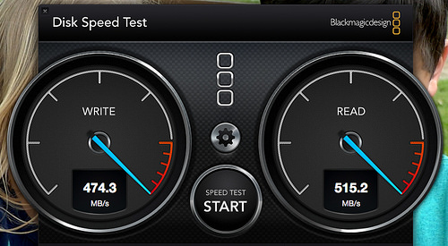

I put a 1TB Samsung SSD & PCIe card in my old Mac Pro 3.1 and it runs much faster.
vs my new 6-core Mac Pro :
