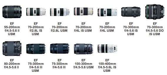

Here's the Canon telephoto zoom lineup (http://www.usa.canon.com/consumer/controller?act=ProductCatIndexAct&fcategoryid=150). None of them have the reach & aperture you really want for indoors work, unless the company wants to shell out for the 70-200 f/2.8. Also, if this is going to be predominately handheld, an IS lens is highly recommended, and a lot more expensive. Figure $1200 or better for a long-reach, fast(er) lens.
You may also want to consider Tamron - they make some perfectly acceptable glass.
A good flash that works perfectly with the EOS line would be the 430EX, about $250 or so. the 580 is about twice that. A flash won't be much use at 60 feet, though.
UPDATE: Tamron's got a nice-looking 18-250 f/3.5 (http://www.tamron.com/lenses/prod/18250_diII.asp) for about $500 online. Might be worth a closer look...

Any thoughts on the EF 70-300mm f/4-5.6 IS USM? It's got Image Stabilization, an Ultra-Sonic Motor and is slightly faster than some other zoom lenses. It's about $550.

At that price, you're better off getting the 70-200 f/4.
The difference between "pro" lenses and "consumer" lenses is not in that red ring that L lenses have, but rather in their better built, and their ability to get the pictures in lighting conditions where consumer lenses would struggle. Your needs are pretty harsh- you're looking for a telephoto lens in the 100-200mm range, which will be used indoors, at a distance where your flash will be useless. You will need to have a "fast" lens, unless you want your pictures to come out blurry, or riddled with noise (yes, I shoot a 5D, noise still shows up slightly at ISO3200). The question is how much you're looking to spend. For about $1100, you can have the 70-200 f/2.8, which I own and love- probably the best zoom lens I've ever used. If you're unwilling to shell out that much cash (yeah, I know it's the company's money, but I don't know thew size of the company), then look into a prime. The 200mm prime can be had for about $650, and will provide you with the aperture you need, and the length you're looking for.
F5.6 is only "slightly faster" than molasses outside today in January.
I would never buy a lens that slow personally. 2.8 or faster - pay once cry once or pay many times and cry many times.....
Buy the 70-200/2.8IS and move on.
Edit: Oh, and if you really want head shots at 60 feet, you're up to the 300mm F2.8 and that's about 5 grand.
Telephoto lenses have a really huge price spread. I know you said you're not paying for it, but in order to get good suggestions, you'd have to narrow down the price range. I'm guessing the budget isn't too big, based on the camera you'll be mounting it on. 300mm is sort of the de facto portable zoom lens, but I think 200mm will fit your needs and will cost a lot less. If you're going to be shooting in doors, you need at least f/4 at 200mm. Naturally, 2.8 would be just that much better, but f/2.8 lenses can be pretty expensive.
If the goal really is head and shoulders from 60 feet, the 200mm f/2.8 prime really is about as good as you're going to get. The problem is this lens obviously isn't as versatile as a zoom, and if you want to take pictures of anything other than the person on the stage, that might be a problem.
