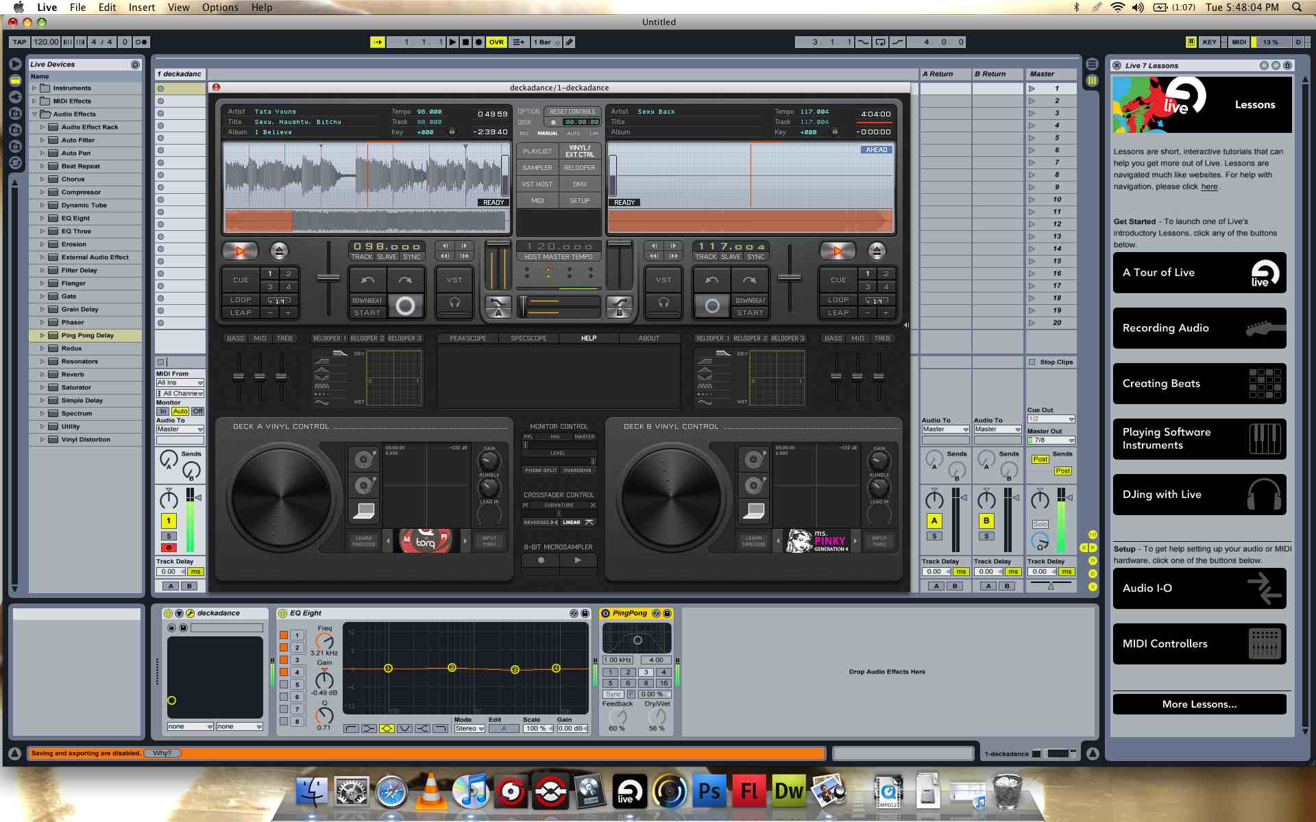

Okay. I been reading up how to add ableton live to my set up and now with all the BS info being given to you, I am going to have to try TSP + Ableton Live on my own and prove that it works.
Do you have a DJ mixer? How many channels does it have?
Are you going for:
Channel 1: 1200 timecoded
Channel 2: 1200 timecoded
Channel 3: Ableton Live
Or were you going to have the master out from the mixing from two tables go back to ableton where you were going to add effects to it?
Please tell me so I can try it out and show the wiring and set info for you. Ill test it out before you even drop a dime on your system.

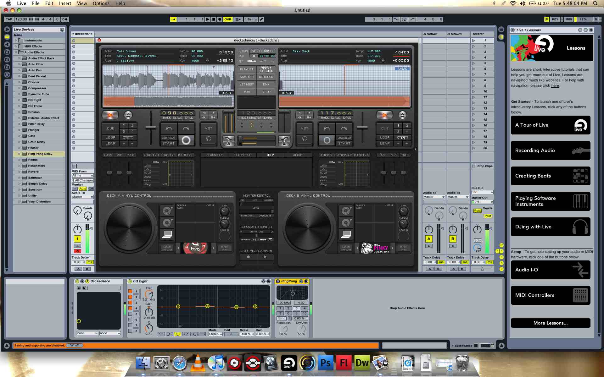

Are you going for:

rjsfnd, I got some good news for you.
While in the bathroom reading Computer Music, I must be the only american that reads this AWESOME UK magazine, I reread the review of Deckadance and how I can run it as a VST. That mean you can run it inside Ableton Live 7 and still have time code control and use all those great things about Live. Im downloading the program and reinstall Live 7 right now.
Im going to try TSP also since it is my favorite DVS program to use.
Ill take pictures and maybe make a video if I have time. Being in college and this only being a hobby makes it hard for me to put all my time into it.
Yea I know, it is a hobby but I DJ only for close friends because iTunes smart playlist sucks.
UPDATE:
I shall let the picture do all the talking. I need to buy serato vinyl to try out the timecoded part.
