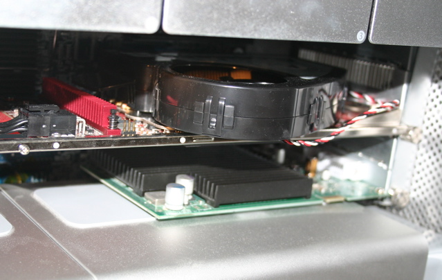

If you can't wait and need your MP now you can replace the cards fan unit with the Accelero X2, which is what I did. It will void the warrenty.
You can see the replacement unit, it's the big black chunk of plastic with the wire coming out. (The 7300 is just below it for comparison). The ATI is now very quiet and my Mac is back to purring like a kitten.😱
